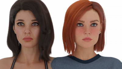

Hi, I've started using Octane this past week so have no point of reference to prior builds. Rendering hair in Octane is taking me 3-4x longer than in Cycles. Has this always been the case or am I neglecting some settings?
I believe I've kept the same settings with only the Octane Hair Settings section being touched. the hair shader in Cycles is using the Principled Hair BDSF. In Octane I've tried both the Hair Material as well as a Glossy Material with both performing extremely slow.
Is there something I could have possible missed?

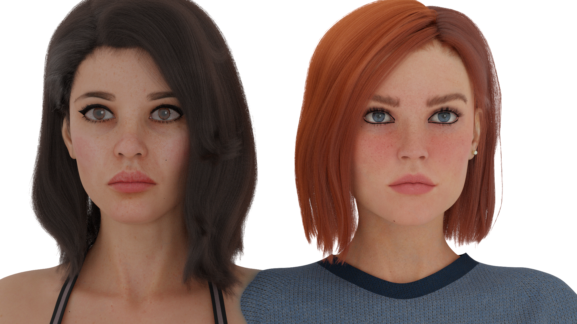

Can we have any insight on Octane particle hair performance in Blender for the 2022 addon version? I don't mean to be annoying but I'm struggling to make sense of this performance.
Using the latest version of 26.3, the attached render used 30gb ram and only 18gb without hair.
Octane standalone rendered with hair using 18gb.
Cycles with hair took 15gb.
I understand that standalone is more efficient and that Octane is more memory intensive than Cycles but do these numbers pass a sanity test?
edit: Tested on 2022.1XB1, same thing.
