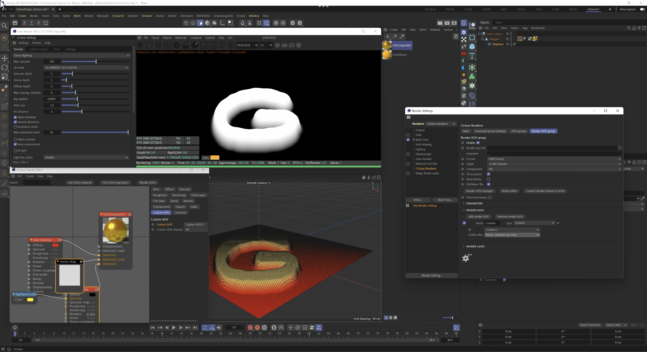

Yo,
I've consulted the manual, watched as many relevant tutorials as I can find, but no luck in cementing my understanding of what I'm trying to do.
Quite literally this, but for/in Octane: https://www.youtube.com/watch?v=iqrISqFY3bQ&t=408s

enable the Custom AOV option only in the Sub-Material of the logo, and change it to Custom AOV 2, or whatever number different from 1, then enable the Cusyom AOV 2 in in render AOV group tab, and cjange the Visible after option from Null, to reflections, then back to Null:

bepeg4d, you're the best in the biz. This worked exactly as I was hoping it would. Thanks a ton!
