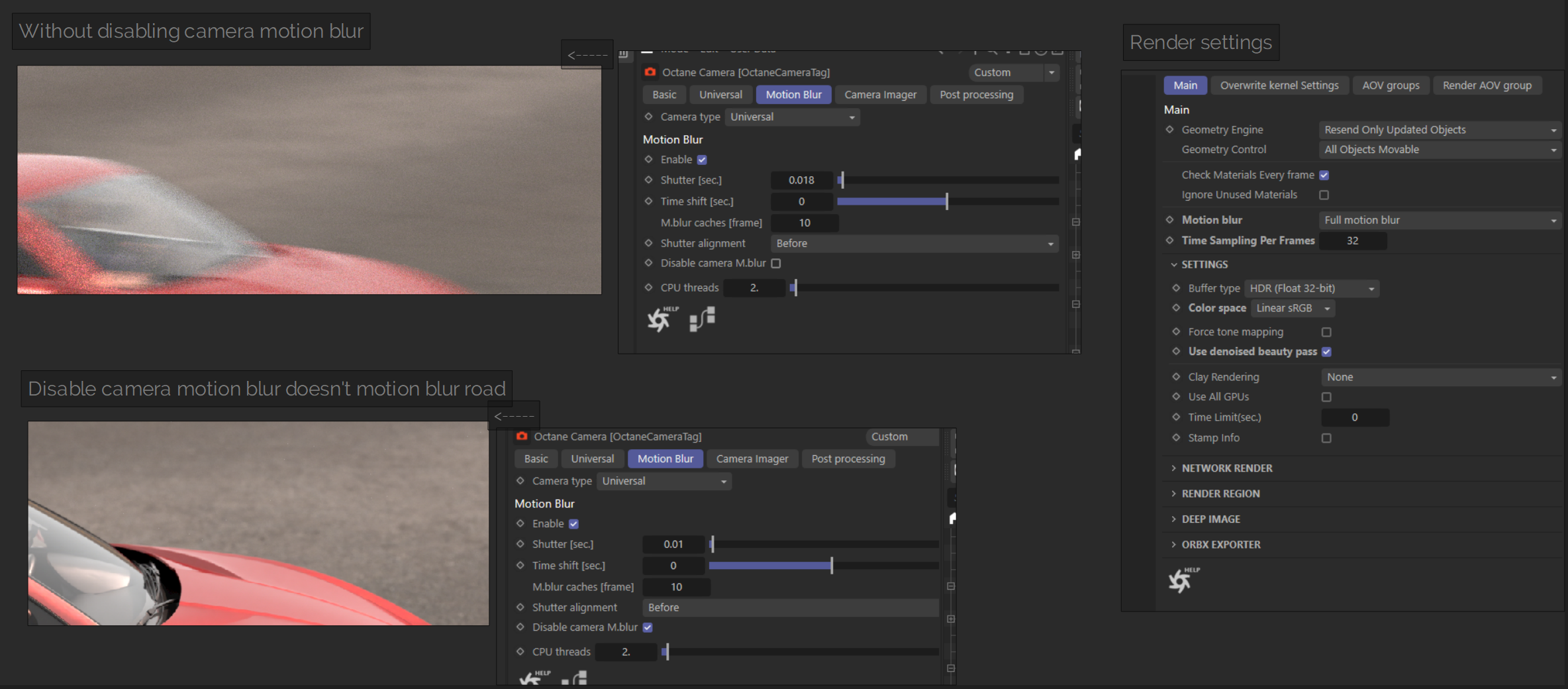

The best settings I got are:
Object tag on car body - disable motion blur
Object tag on spinning wheels - transform motion blur
Object tag on passing scene/road - transform
But I have to disable motion blur on the camera otherwise the entire scene blurs including the car.
However, the passing scene/road does not get the motion blur.

This is FAQ topic and having many answers in forum. Nothing so difficult if you understand the logic. Camera should have the zero motion relatively to CAR. Like linking it to CAR. See example scene.
car-motionblur.rar
(4.15 MiB) Downloaded 83 times

That scene file helped, thanks.
