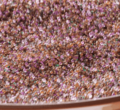

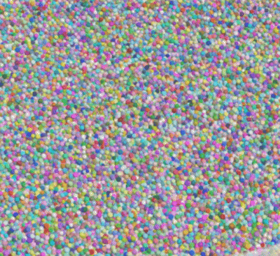

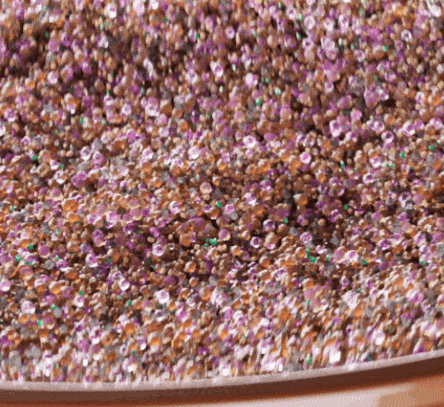

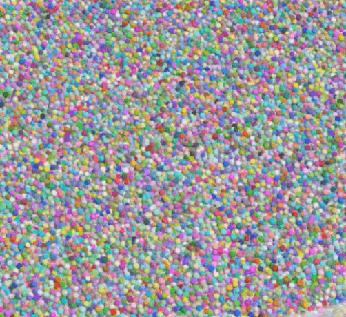

Well I got this rendering but the final render has some wild jittering on all the instances - I have a flip of the whole thing looking just fine so it seems this is happening at render with the instancing. Is this a known issue? How can I fix it - The scene is set to full reload every frame.

just a guess....do you have a constant flip point count....like do you simulate with reseeding off ?
If no you should sort your point count according to the id attribute to get consistent result using instance .
Oh and correct me if i m wrong but flip do not export all the needed attributes to get correct orientation (as they are initially made for remeshing)...nothing you can t tackle or fake but i would investigate this in a first place...take a look to the standard instances attributes ....things like Up(VECTOR),N(VECTOR),rot(QUATERNION),orient(QUATERNION).
And what is your second Gif preview ? packed primitive using copy sop ?
