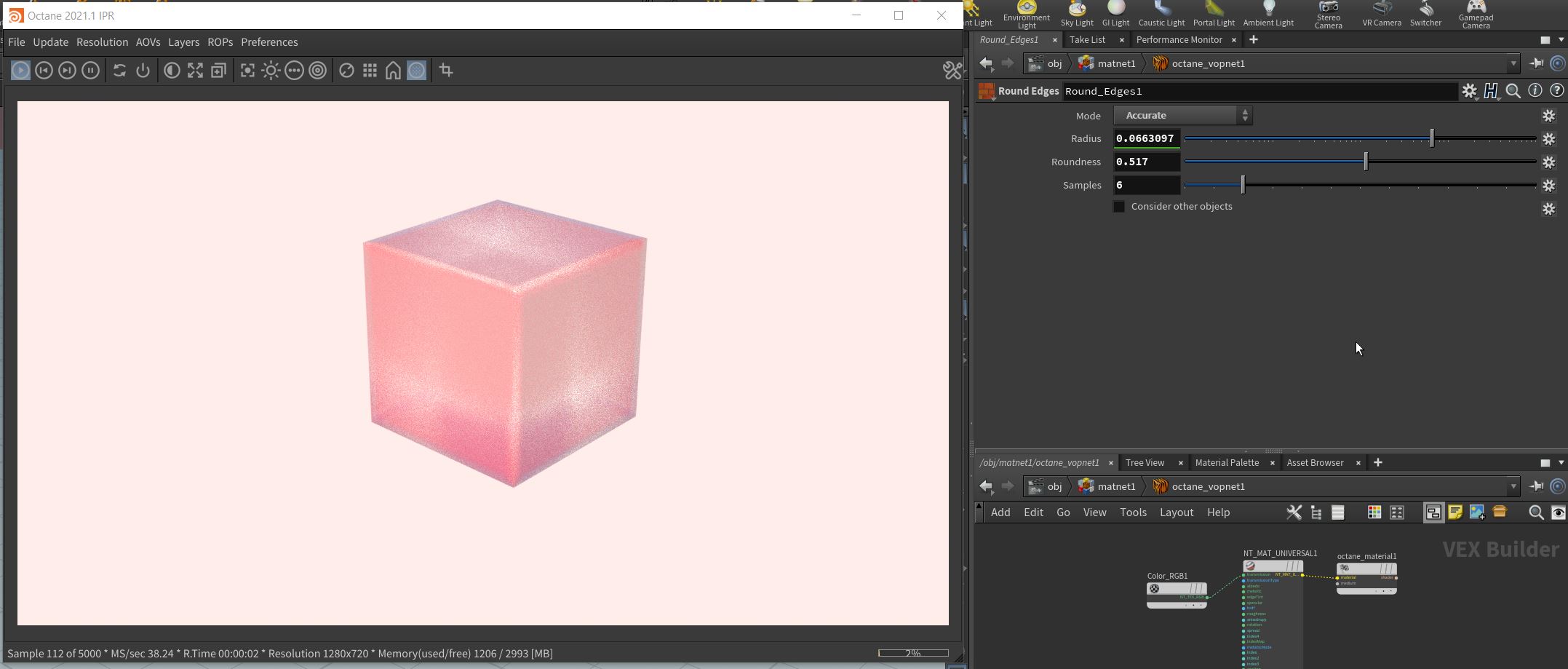

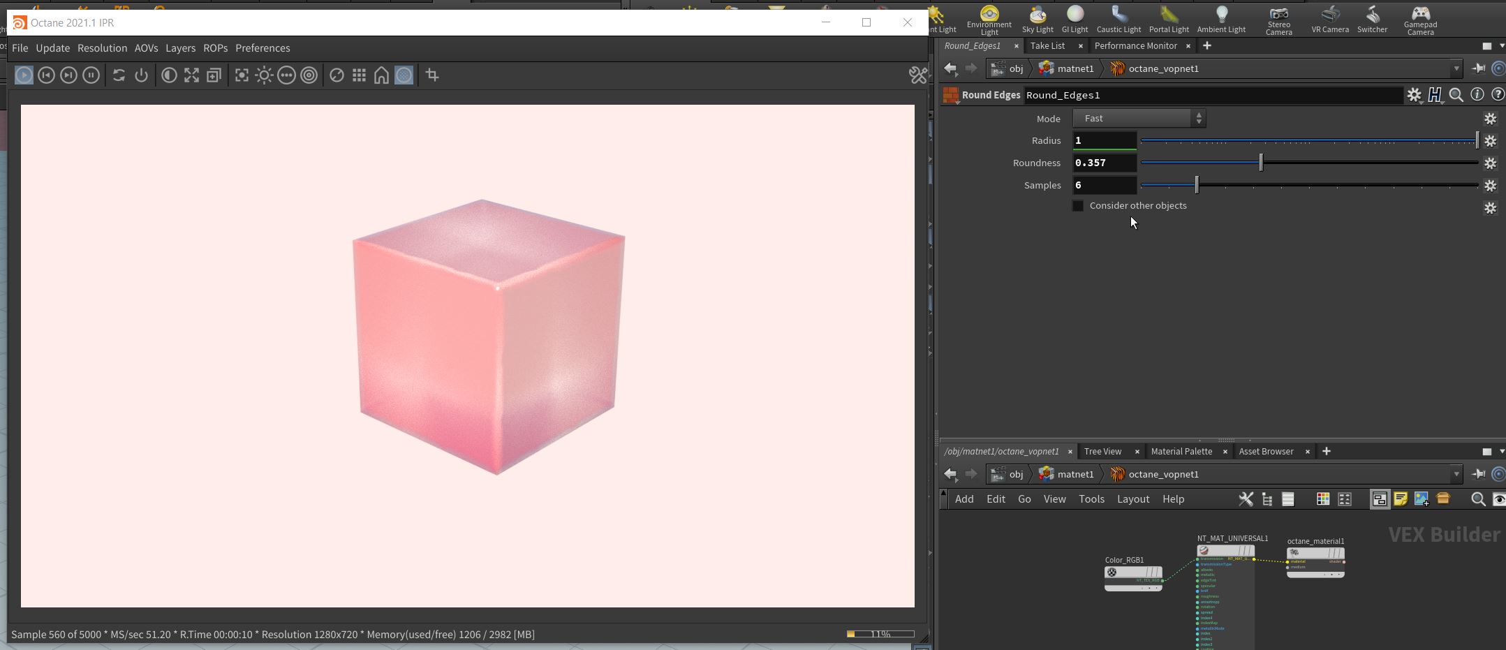

Here this feature seems to work fine in both modes. Be aware that the radius parameter is not the same, but once adjusted it should work. This is using Octane 2015.1.5.0

Hi Juan,
Thanks for the quick response!
The difference between fast and accurate values is not critical I guess as long as either mode scale linearly with object scale.
Thanks again
