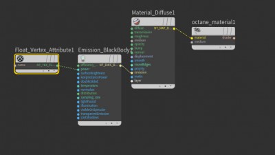

Is that possible to read point/vertex/primitive attributes to drive "power" parameter in the blackbody emissive shader? I tried everything in all combinations possible with no success. Help me, please

Nope, sorry. Probably this input is not compatible with vertex attributes. Have you tried to use the "efficiency" or "distribution" inputs instead?

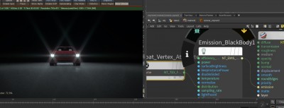

yes, but I can't truly control the intensity of the light cause when I plug my attribute to the distribution pin if the value of my attribute is 0 it still keeps sort of the dim light in the scene despite the light sources are not visible, see the attachment. And if I plug that into the efficiency it increases the light intensity tremendously no matter what value I'm feeding this attribute with. Is there any possible way to control lights intensity color etc with the attributes? Then if not it means that the procedural approach isn't possible with the light?
