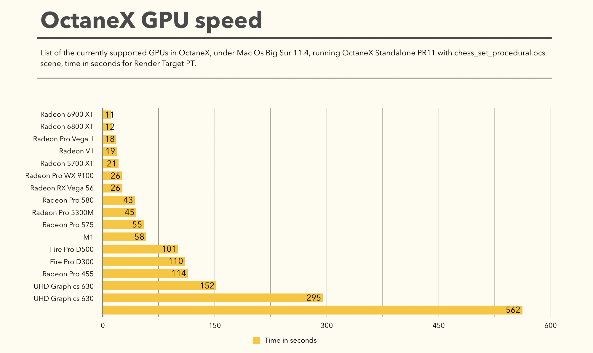

Also note that Intel GPU is the weak GPU you can have on a Mac.
Better to connect an eGPU box via Thunderbolt 2 or 3, with an AMD GPU inside, like 5700, or 6800/6900:
