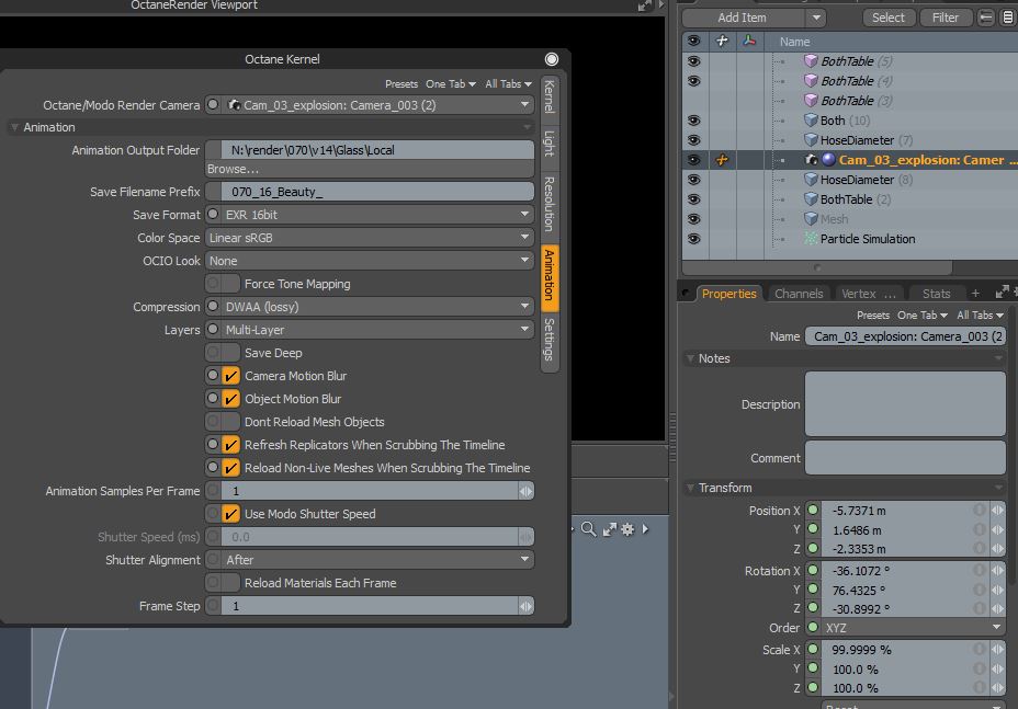

I am running into problem here.
ORBX does not export the animation of my camera.
(I checked it with stand-alone and on RNDR)
The scene has a camera with motion blur and particles with replicators.
Camera has baked animation keyframes (translation, rotation)
I tried Modo 14.2.v2 and Modo 15.2v3 (Win)

How specifically are you exporting the animation to ORBX please?

it was just the standard export through the octane plugin (export animation)

Thanks Andras. I could not reproduce this problem. Are you able to send me a simplified scene which demonstrates the issue please?
