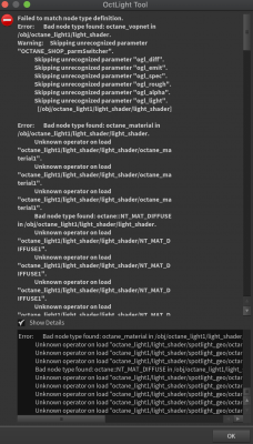

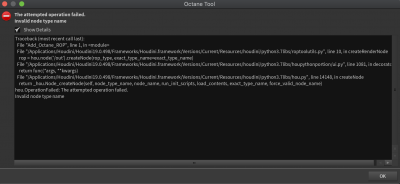

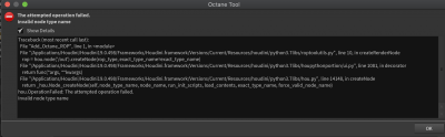

I'm running Houdini 19.0.498 and the most recent plugin available seems to crash when selecting any of the Octane menu options. The first attachement is from the released PR11 plugin and the last two are from the unreleased plugin linked in another darwin houdini 19 thread. my env file is:
`HOUDINI_PATH = "/Users/foo/Octane_OctaneX_PR13_Houdini_19.0.455_OSX_vr;&"`.
what's the status with octane houdini plugin support?
I needed to manually tell gatekeeper to let dylibs run from anywhere, are octane dylibs not registerd with Apple?
Macos (Metal / Bigsur) Houdini 19 status?
