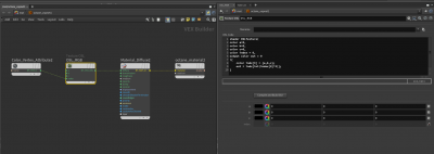

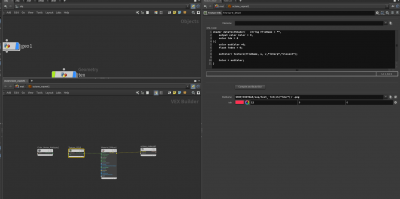

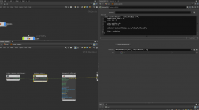

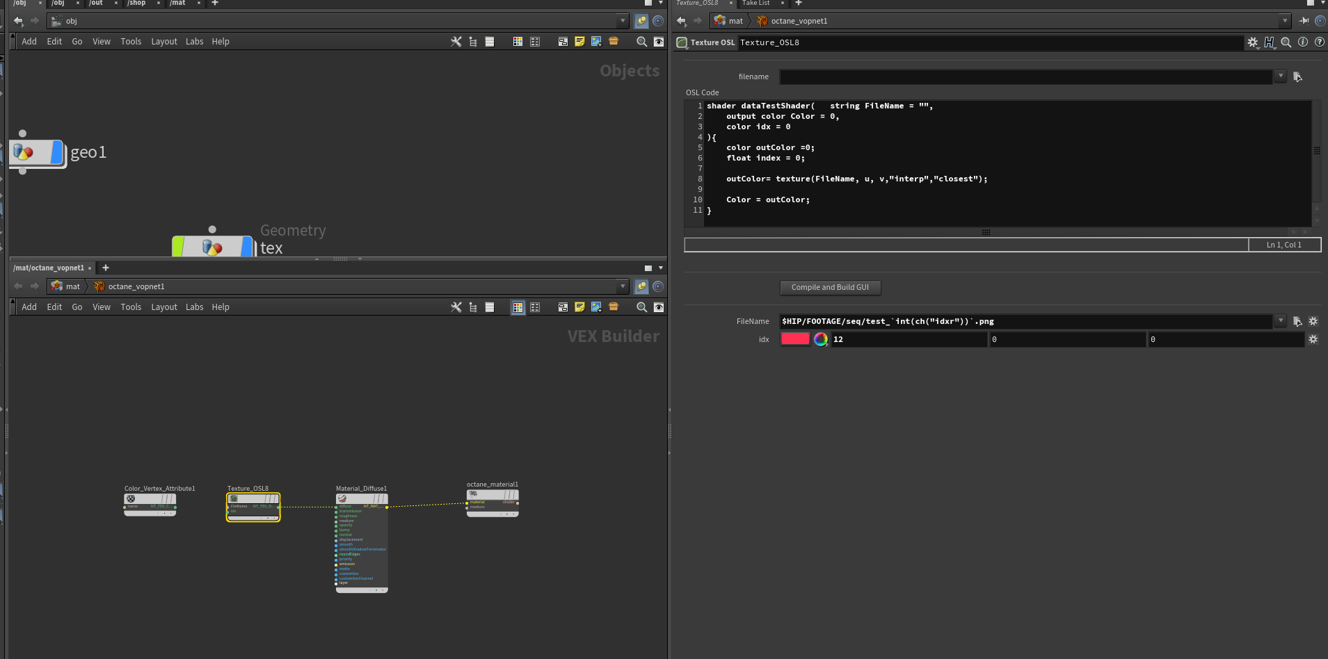

i now have part of the solution,
i got an OSL Texture shader to display one image out of a sequence, triggered by a value,
as shown in the screenshot
but when i plug in a vertex attribute with the same value it stops working ...
but WHY?
(i used a vector value because i learned that osl doesn´t understand float vertex input somehow)
and also there seems to be no string format() function in OCTANE OSL ...!?!
i tried the following instead of using the hscript index-replacement, but with no success:
format("$HIP/FOOTAGE/seq/test_%i.png",int(idx[0]));
many thanks for any ideas!!

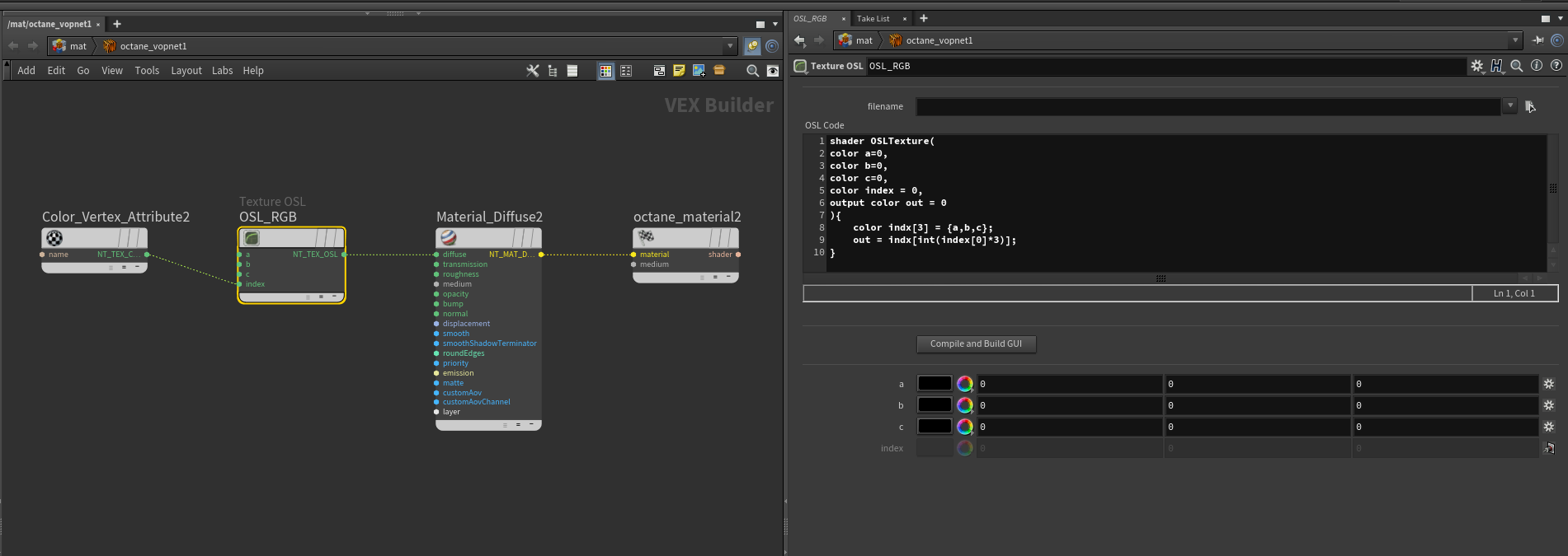

i think you`re right,... load all tex into osl and then select by attrib should work...
by now i can tell that vertex attribs work in osl but only VECTOR not float (don`t know why)..
as in the following setup:
shader OSLTexture(
color a=0,
color b=0,
color c=0,
color index = 0,
output color out = 0
color indx[3] = {a,b,c};
out = indx[int(index[0]*3)];
best
jan
