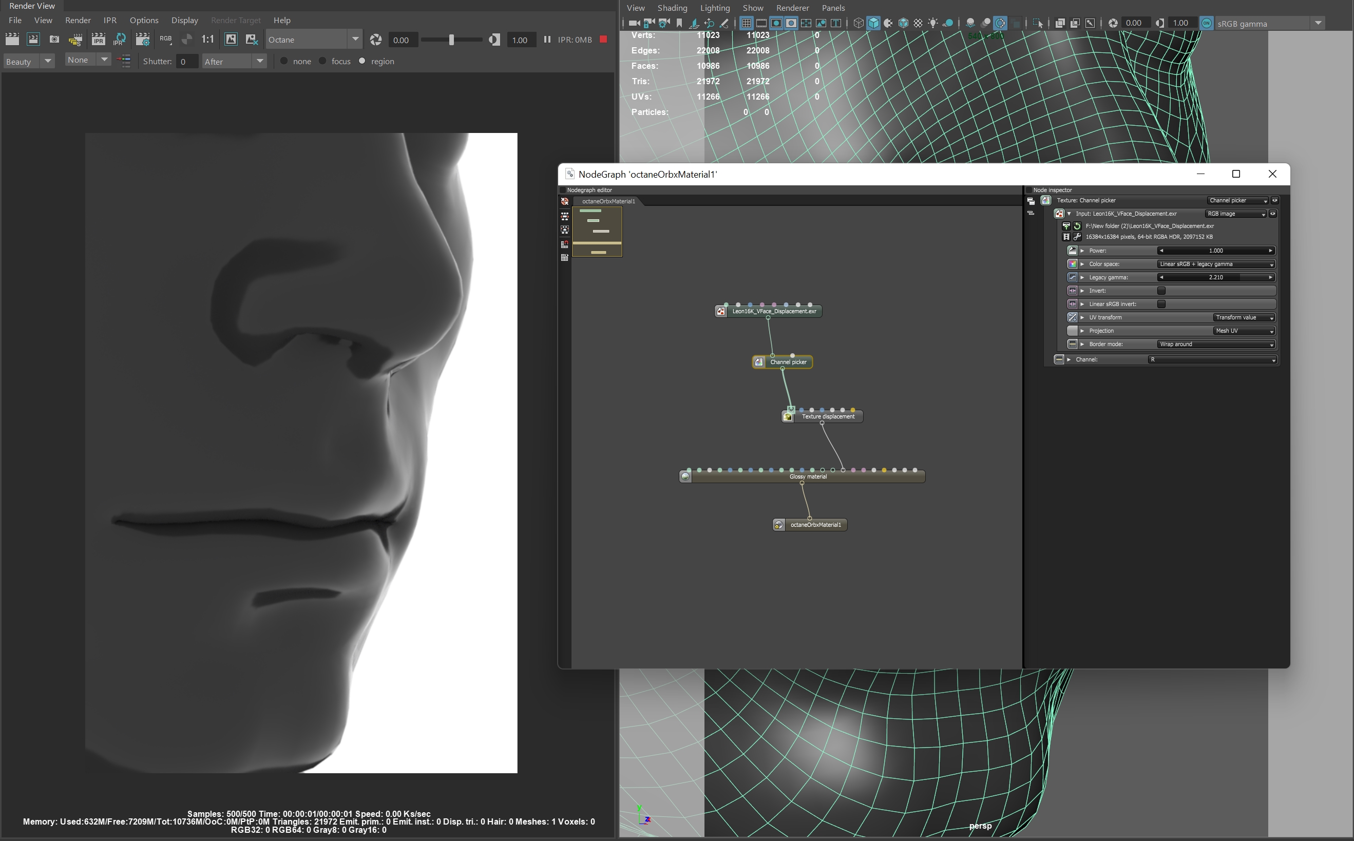

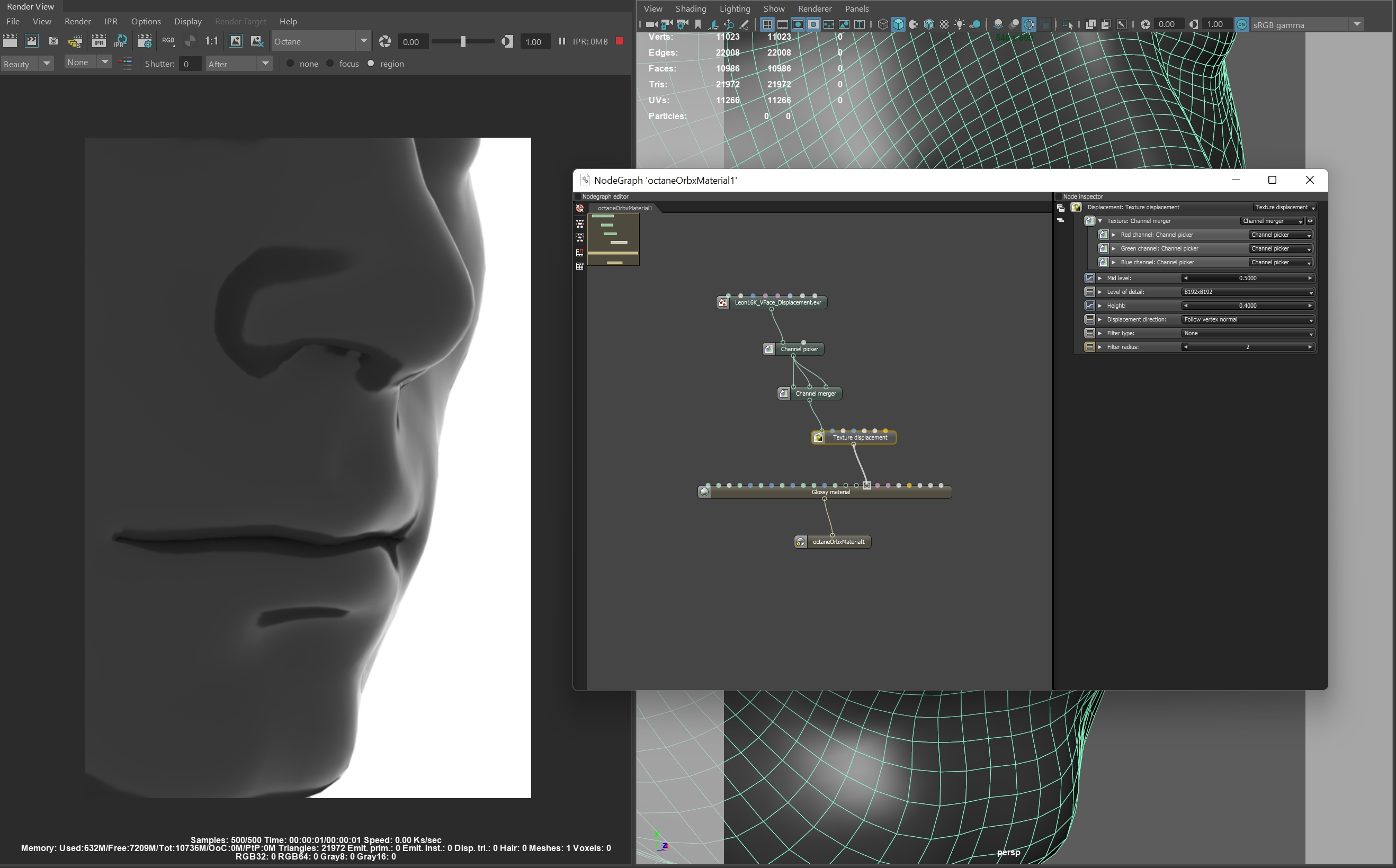

Ok I don't know if this is broken or if I'm doing something wrong, but it doesn't work.
if I plug the displacement directly, I can see something (it's wrong, it's not supposed to look like that) if I attach a Channel Picker, the displacement disappear same if I add a Channel merger Can someone explain me what's goin on?

The Texture displacement node doesn't work with procedural textures so you'll need a Baking texture after the channel picker or channel merger. Or use Vertex displacement.

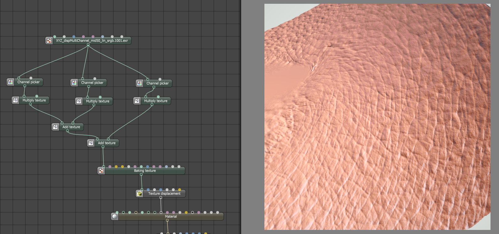

The utility node is procedural and it's the one plugged into the displacement, this includes channel picker, channel merger, multiply, add, etc.It's not procedural, it's a 32bit .exr texture.
Whenever we use one of these the result needs to be baked if we intend to plug it into the texture displacement.
Thanks for the sample.
OK I made this graph based on the "simple workflow" of this documentation page:
The "Multiply" nodes control the influence of each channel (large/mid/small scale details) and the "Add" nodes recombines them together.

Thank you jobigoud, I will try to reproduce your graph in my scene.
It looks like your displacement is inverted, but that should be an easy fix.
