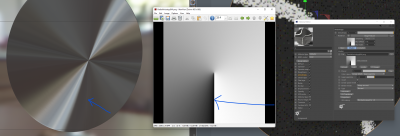

In the attached scene I have a swirled, radial, anisotropic reflection on a round label. It works 99% perfectly, but where my rotation texture flips back from black to white at the 6 o'clock position, you can always see a line in the reflection. Does anyone have a suggestion on how to avoid this?

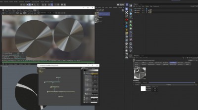

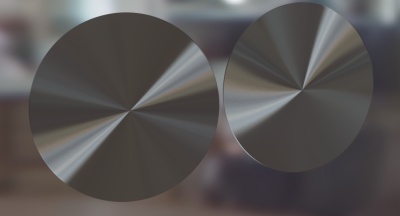

That should be the solution in theory, but in practice it doesnt work due to the srgb/linear interpolation of c4d's gradient. Left is the pixel based texture, right is the c4d gradient shader. The incorrect gamma input skews the anisotropy off into a curve. Gamma adjustments on a colour correction node cant fix it. Octane doesnt support the different c4d gradient interpolation modes (smooth, linear, cubic etc) so you can't fix it that way either.

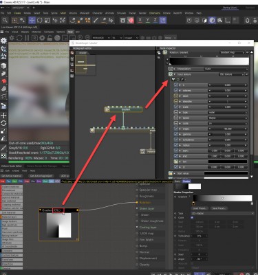

There's not any sRGB interpolation. Because it's not baking the gradient to images. It's using some OSL script to simulate the gradient and you can see the exported node in this picture.boxfx wrote:That should be the solution in theory, but in practice it doesnt work due to the srgb/linear interpolation of c4d's gradient. Left is the pixel based texture, right is the c4d gradient shader. The incorrect gamma input skews the anisotropy off into a curve. Gamma adjustments on a colour correction node cant fix it. Octane doesnt support the different c4d gradient interpolation modes (smooth, linear, cubic etc) so you can't fix it that way either.
The OSL translation is setting the gradient interpolation to Cubic, so you need to export the material in .orbx from Node Editor, open it in Standalone to change the interpolation to Linear, save the material in LocalDB, and import it back in c4d:
In this way the interpolation is correct, and the gradient stays procedural.
