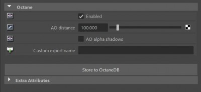

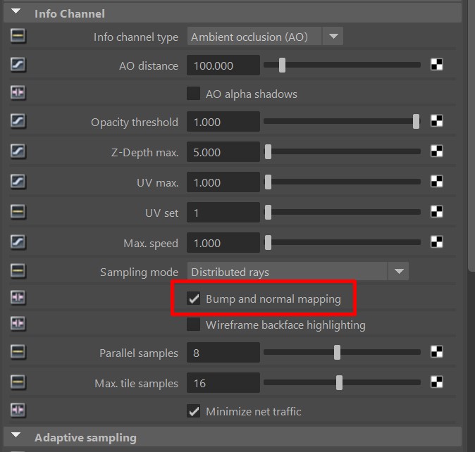

One problem tho. The AOV pass of the Ambient Occlusion does not have the option to include the Normal Map or Bump in the calculation, like it has in the Info Channel.

We got confirmation that we would be adding an option to the ambient occlusion AOV for bump and normal mapping.

That was an oversight from me. We will add an option to toggle bump/normal mapping for the ambient occlusion AOV in 2021.1.4.
Until then, if you add another AOV that has this option (i.e. shading normals or texture tangent), or just simply the tangent normal AOV, the ambient occlusion AOV will also be rendered with bump/normal mapping.
