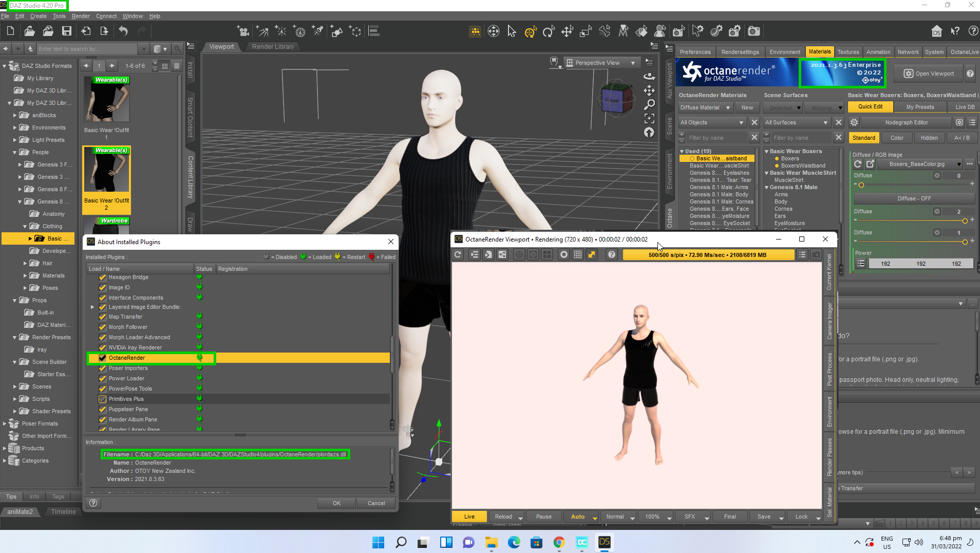

Hi cridgit,
Sorry for the late reply as we had to arrange a workstation with Win 11.
In our test OctaneRender for Daz latest build, v2021.1.3.63 worked fine in the image below.
- First, we installed the Daz Central>Downloaded the Daz v 4.20> installed OctaneRender for Daz as usual.
Would you please try *Run as Administrator* to install the OctaneRender for Daz plugin and see if it works?
Also, make sure to point to the right DAZ3d path!
