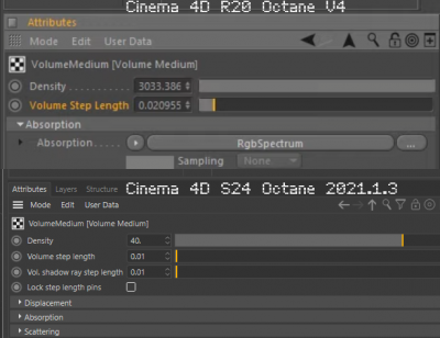

I have returned to Octane for a project at work.
Everything works fine, but there has been a change in either Cinema 4D or Octane since I last used Octane.
In the VolumeMedium we used to be able to have way more decimal points accuracy in the Volume step length parameter.
I'm watching an older instruction from Cinema 4D and Octane V4 and in that video they have six points of accuracy.
In S24 and Octane 2021.1.3 I only have two points of accuracy.
Is this a change from Maxons side in Cinema 4D, or is this a change in the Octane plug in?
And is there any workaround so i can get more decimal points?

I've checked it and it's working as expected. Having 6-digits, not sure why you cannot see it. Maybe you're not using native Octane sliders. Check Settings window for that.

I switched over to "octane default" instead of "octane c4d like". I can now see more digits(which is good), but the slider still rounds up everything under 0.01.
