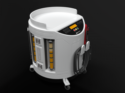

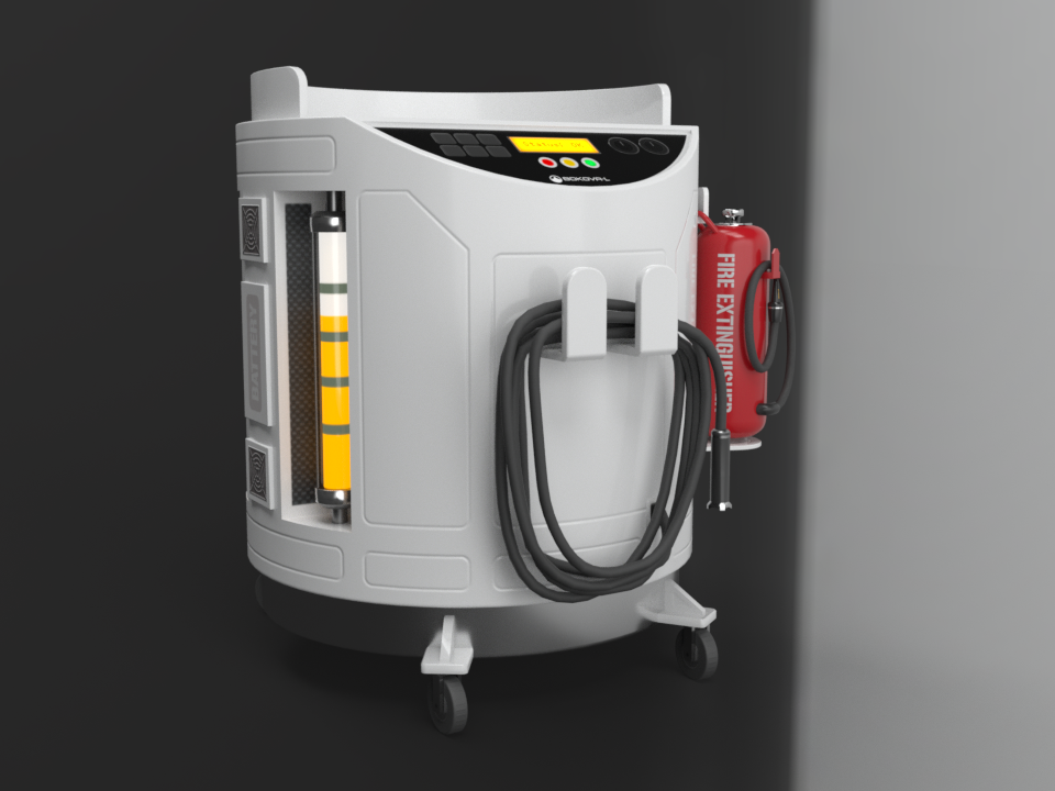

So I found problem when using the universal material with the latest plugin update. If I have a surface that uses a metallic map and an emission map, the surface will become much more brighter/reflective than it should be. I have some examples attached to this post. In the small device example, the material looks fine with all maps minus the emission map, but as soon as I add the emission map the surface becomes brighter/more reflective.

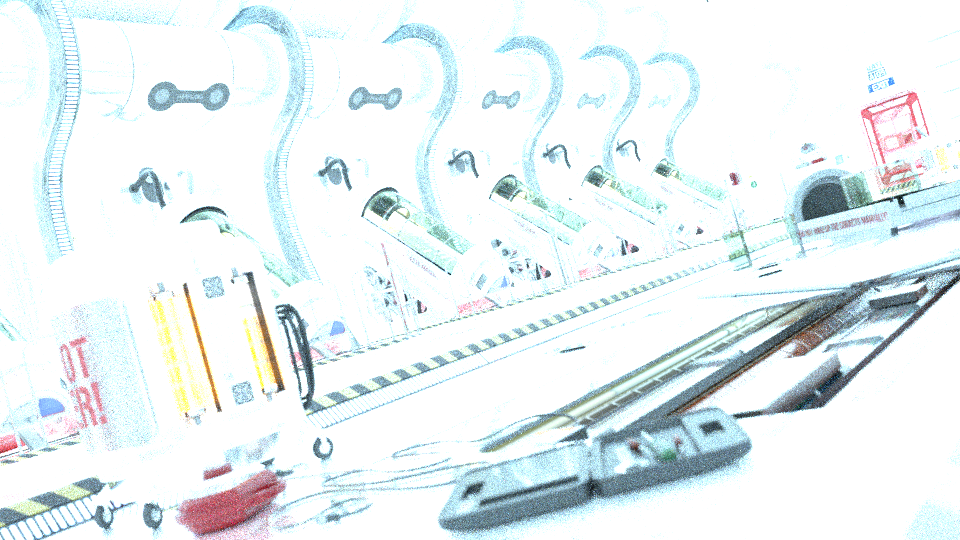

a whole scene that uses similar types of surfaces that renders completely blown out now.

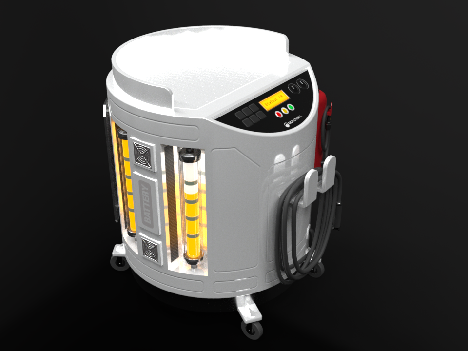

with emission map added.

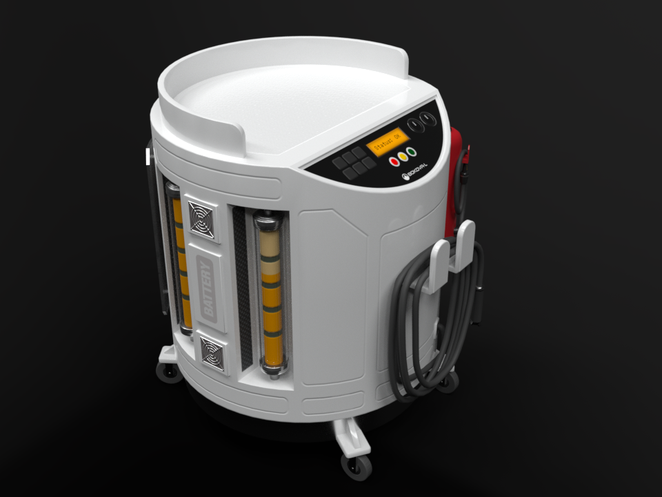

all maps minus the emission map.

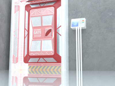

Some more examples
without emissive map
with emissive map
with emissive map

Maybe wrong gamma settings on the emission map resulting in the entire object beeing slightly emissive?
In my experience some greyscale images are intended for gamma of 1.0 and others for 2.2. Maybe change it to 2.2 if its currently at 1.

Banti wrote:Maybe wrong gamma settings on the emission map resulting in the entire object beeing slightly emissive?
Messing with the gamma does nothing. And as it worked in the previous version fine, I assume it to be a bug.
