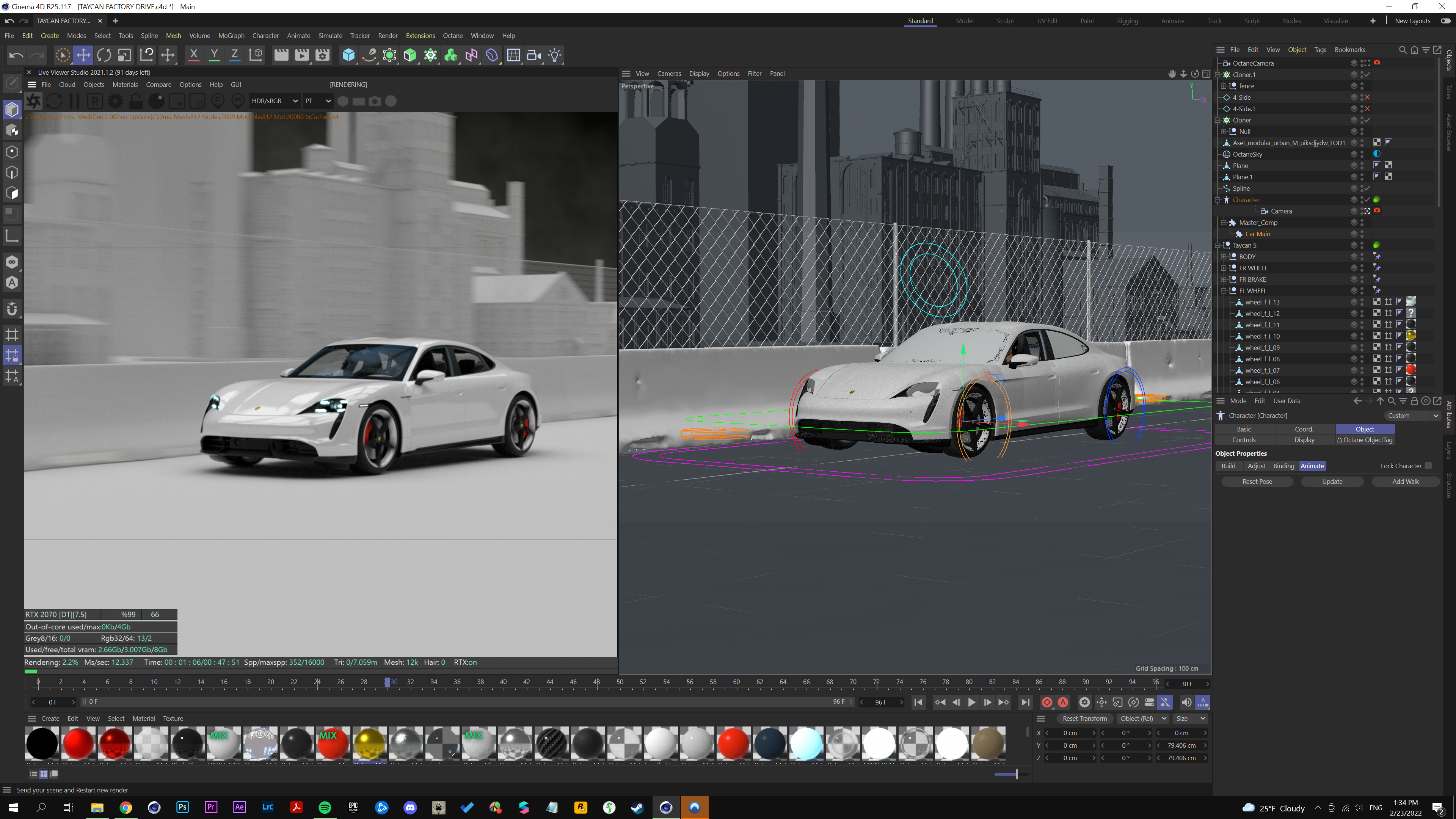

Hello,
I know this has been asked before, but I have a variation on the problem of inconsistent motion blur. I've read the other posts and seem to be getting closer to a solution but there's always one more issue.
I have a camera tracking with the vehicle in the scene. When I send my scene to render in liveviewer, everything looks great. That is, until I advance to the next frame where everything is blurred. This is fixed when I resend the scene, however is still there when I play the scene forward.
Attached are screenshots of scene and settings
Thanks! Let me know if anyone has encountered something similar
jayroth2020
Posts: 496
Joined: Mon May 04, 2020 7:30 pm
Live Viewer is not meant to preview motion, it is meant to preview materials, shading and lighting. Live Viewer will show motion blur, but not accurately. The only way to see frame accurate motion blur is to do an actual render.
