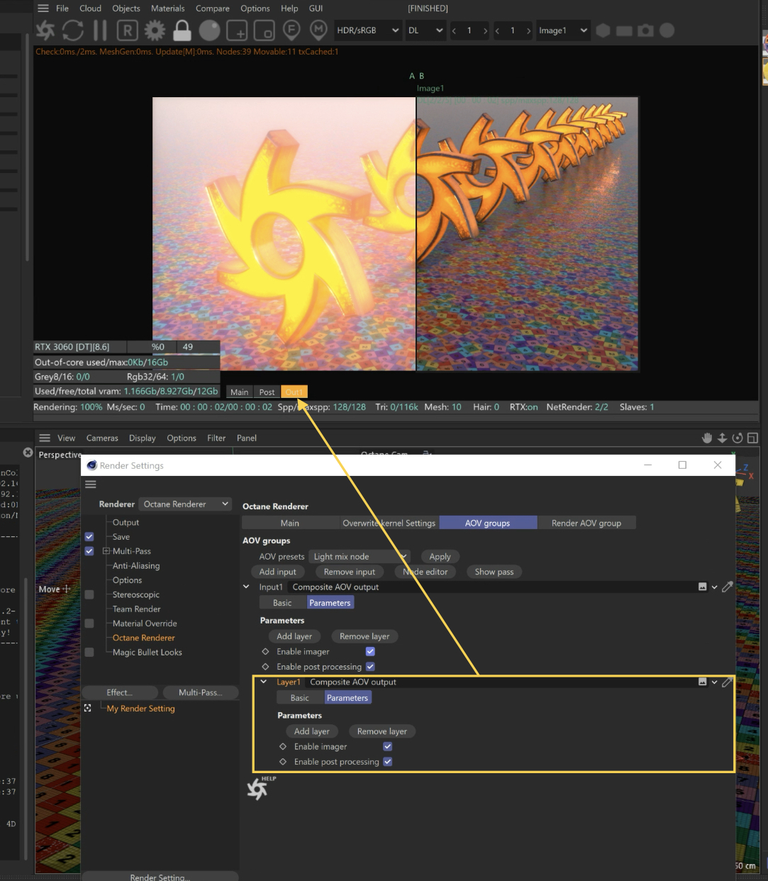

It would be very useful to see the beauty pass + post processing applied in the Live Viewer even if we chose to render PostProcessing in a separate pass.
At the moment if you chose to have PP in separate pass, it separates iteself in the Live Viewer. This is useful sometimes, but it would be great to have the option to see the beauty pass in LV in order to properly art direct what we want the image to look like. Instead of unchecking render pass, looking at LV, then checking render pass again to have it separate.
Know what I mean ?
Posts: 10637
you can add a Composite AOV Output layer in the AOV Groups tab, to add a full output pass also in Live View:

I had no idea, grazie Bepe :shock:
