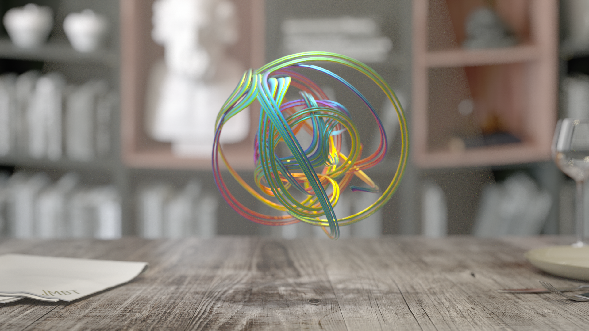

I can't speak to Shane's situation but look at this on my end:
This is Twister D v4 straight out of octane. This is Twister D v6 straight out of octane. On my end those look very different regardless of whether they're in photoshop or after effects or preview or whatever.
And to clarify, both files have octane settings set to SRGB (and the C4D project settings are also both set to SRGB & Linear Workflow).

And to further complicate things here's the same project rendered out of my laptop instead of my desktop. Same exact project but different result.

Your problem is multipass is enabled.
A standard c4d/octane render will render out to the regular old srgb colour space until you start changing settings. When you enable multipass though, c4d must switch its output system to linear output, because compositing all those layers together in srgb space is impossible, only linear works. Your V4 file has multipass enabled, your V6 file has it disabled, so they are rendering the same thing, theyre just putting it and thus showing it in completely difference colour spaces.
enable multipass / Render AOV to make the v6 file brighter, or disable it in the V4 file to darken it down like the v6 file.
Technically your V6 file is correct, but obviously do whatever works for you.
