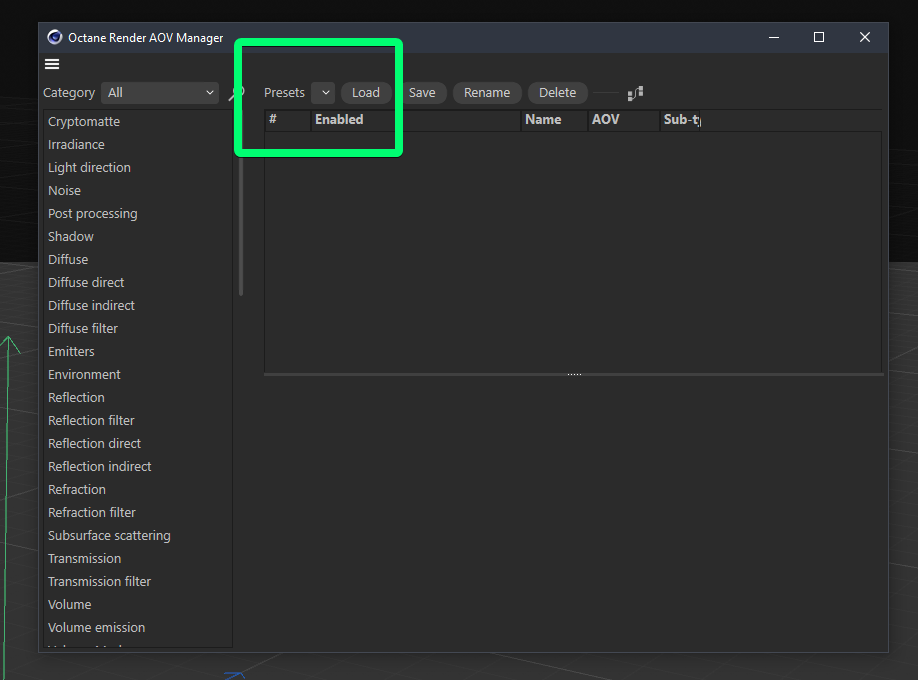

I had 3 presets in AOV manager which were default (I assume). I used them quite alot but they seem to have disappeared randomly. I havn't updated or anything and I'm on on Octane 2021.1.1 and C4D R25.
I even tried reinstalling Octane C4D to see if it reset the default ones.
Also, where are the presets actually stored for when you save your own so I can back them up?

delete "rndaovpr.dat" file from Prefs directory to reset it back
