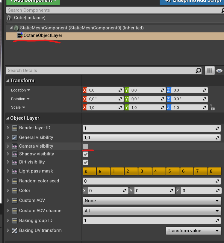

The plugin is capable of doing this for most object.
In unreal, select your static mesh component, and add a new component called OctaneObjectLayerComponent.
Select this new component, and turn off "Camera Visibility".
Example:
Example:
