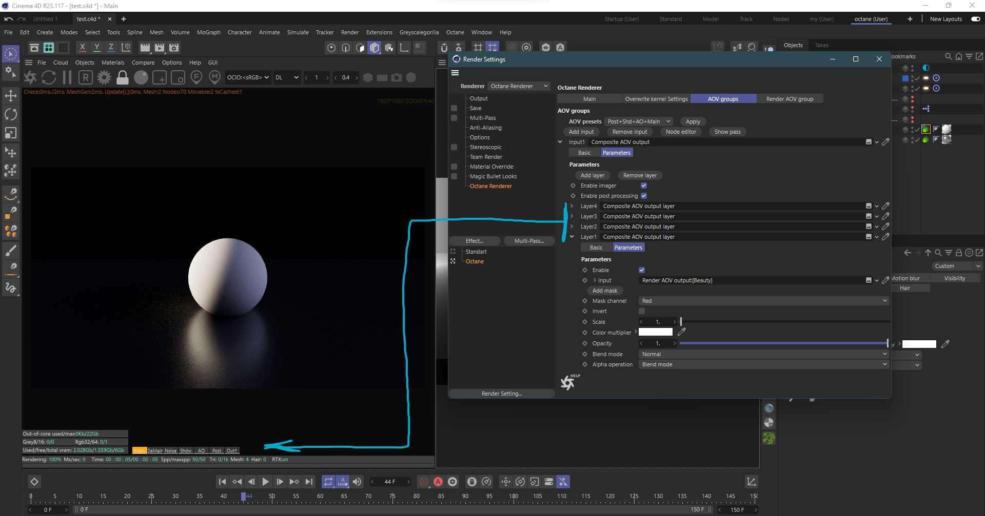

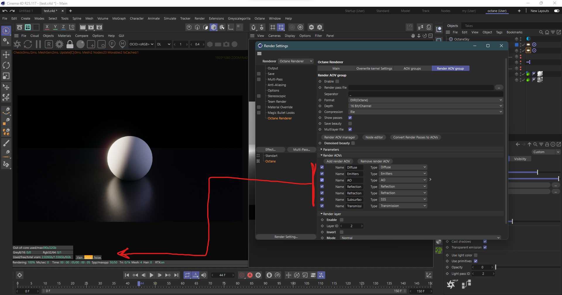

Hey, is that a bug or what — can't see any Render Passes in Octane Live Viewer when use Render AOV Group tab. AOV Groups work fine.

Correct way is this, see picture. Each "Composite AOV output" goes to one output on render.
