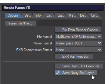

Why in some cases Octane saves two passes - rough beautiful (main) and with denoiser (de-main), while in others, with exactly the same settings, it saves only the denoiser pass?

Perhaps it has to do with the "Save Noisy File/Layer" option available in the passes node.

Yes, thanks, yesterday I found this option by trial and error on my own.
