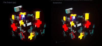

So again I'm stumbling upon this problem which I need to FIX ASAP and did all I could think of but still the ouput is as bad as you can see.
Did try to save it as PNG ot TIFF bit nothing changed, I can already see from the screen some weird gradient that should not be seen but the output is simply afwul, is there a setting I'm not aware to avoid this? i'm on 4.05 - 6.34 / Linear Off ) but changing it makes no different , use 100 Sampling x slot on the blackbody Emission and it was 1 by default.. nothing..
Need a fix.

Hi justix,
a linear gamma .max sample attached.
Regards
Paride

elsksa wrote:Hi justix,
Below are some my pages that partially cover this vast subject:
https://www.elsksa.me/scientia/cgi-offl ... rvival-kit
https://www.elsksa.me/scientia/cgi-offl ... management
https://www.elsksa.me/scientia/cgi-offl ... mat-debunk
justix wrote:use 100 Sampling x slot on the blackbody Emission and it was 1 by default.. nothing..
If you are referring to the light sample rate, it is not a sampling option.
The shortest and simplest description is that it prioritizes (depending on the value: 1, 2, 3) the sampling for scenes containing more than one light.
thanks
