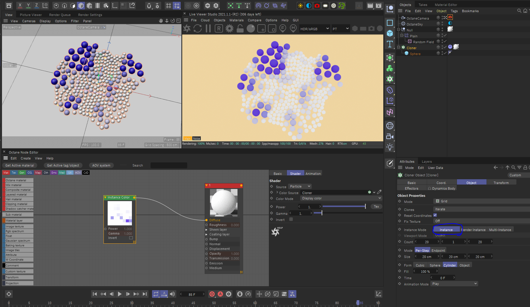

Affecting the cloner using plain effector and random field, the color from the plain effector doesn't work properly when using cloner in multi-instance mode.
Is this expected behaviour?
Using R25 with Octane 2021.1.1
Cloner Multi-Instance + Octane

It's not! If you check it with other modes that's working well, but with not with grid/sphere, grid/cylinder. Go with render-instances or with multi-instance and by a different mode for now!Meet wrote:Affecting the cloner using plain effector and random field, the color from the plain effector doesn't work properly when using cloner in multi-instance mode.
