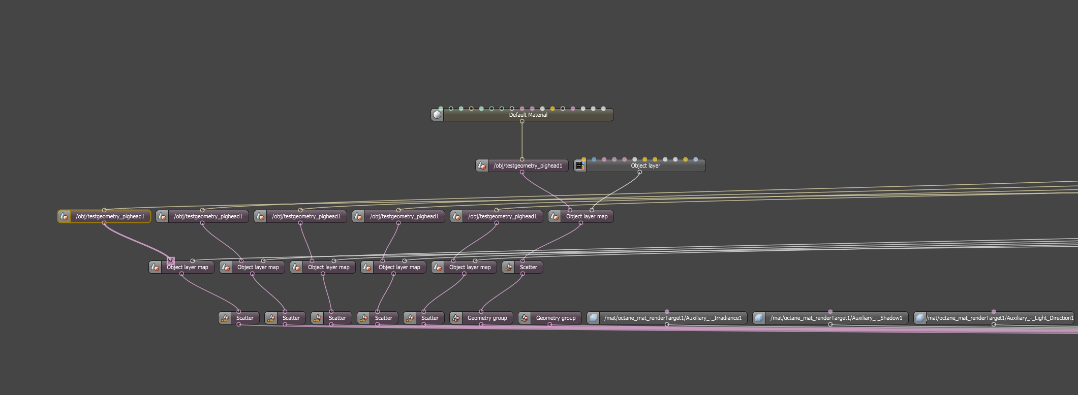

Hi Juanjo,juanjgon wrote:I've been investigating this issue and I think that the problem comes from the .orbx files themselves. They have a weird node graph, as you could see if you open them in Standalone. Perhaps the problem comes from exporting them after updating the scene from the previous one or something like that. Have you tried to export the .orbx files one by one after closing/opening Houdini for each one? I need to improve the .orbx export function for proxy files. The current scene tree is not the best one for this kind of objects, because in the end it had been designed to render the .orbx scenes, not use them as proxies.Ferdinand13 wrote: Here's a link to download the project and the ORBX proxies on Dropbox:
Hope you can find something in there. Thanks!
Thanks,
-Juanjo
I finally found some time to check the ORBX exports from Houdini. However, I quickly ran into a couple of roadblocks, since I don't quite understand the logic behind the exporter of the Octane Render plugin for Houdini. So I've got a scene that's empty apart from one pighead geometry object, which doesn't have a material applied. When I load this into the IPR and right click to export an ORBX, this is what I see when opening up the resulting ORBX file inside Standalone: The pighead geo is present around 6 or 7 times and there is a crazy amount of other nodes in there that I didn't even want/need to export. Can you explain what's going on there? What I'd expect to see would be one geometry node for the pighead with a Default Material and the Render Target present. What's all this other stuff?

All this stuff are the Octane nodes inside all the scene VOP nodes (even if they are not used), plus all the nodes created while updating the scene and so on. The .orbx export from the IPR window is there only for debug purposes, so it can have a lot of crazy stuff. You should export the .orbx files from the ROP node, in full scene reload mode, and even in this case, you are going to get a lot of not used nodes because in the end this feature was designed to export files for rendering, not to be used as proxy objects, so the nodes tree is not cleaned at all.
I need to design a new export feature for proxy files, without all this additional stuff, but I need to think about it, but as I've said, the .orbx files are not exactly designed to work as proxy objects in other scenes.

Hi Juanjo,
Thanks for explaining. I did some more 'in-depth' testing inside Standalone and have now come to the conclusion that an ORBX file containing nothing more than a 'mesh' node is still valid and shows up correctly when importing the ORBX back into Houdini. So, even if it's a bit more work, I can export geometry as an ORBX from Houdini and then just delete the entire spaghetti ball of unused nodes inside Standalone, then importing the ORBX back into Houdini and I've got the 'Proxy' file I'm after. At least that's what it seems like
Do you approve of this workflow as a workaround for now?
