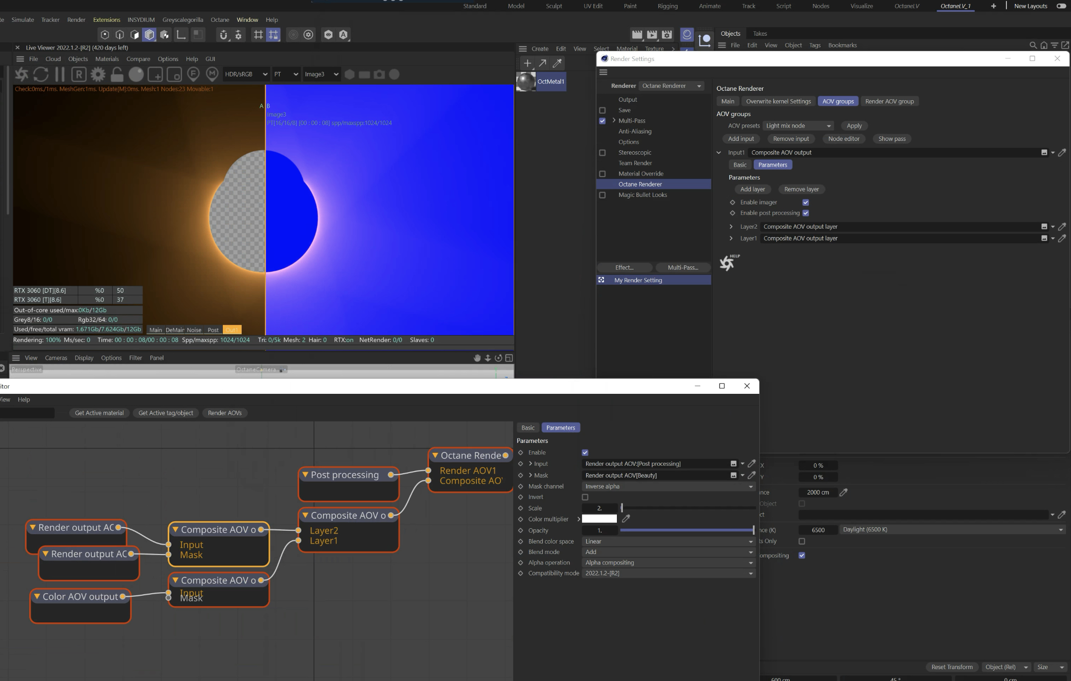

Ok, here is a completely different approach.
I have used the OctaneRender Compositor in Render Settings/OctaneRender/AOV groups tab to obtain an enhanced version of the Post Effect AOV, and masking it with the Inverted Alpha channel of the Beauty pass:
There is also a Color AOV to check the result on the right.

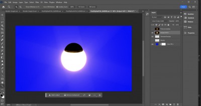

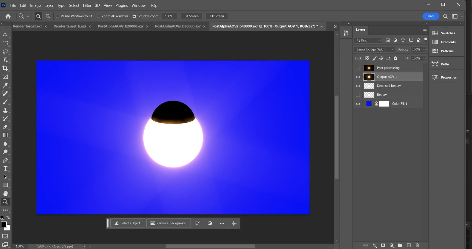

In this way, in Photoshop, you just need to Linear Add the Out1 AOV on top of the Beauty, or Denoised Beauty AOV:
Here is with same blue background for comparison.
