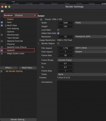

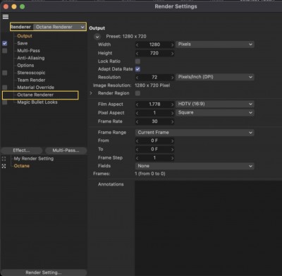

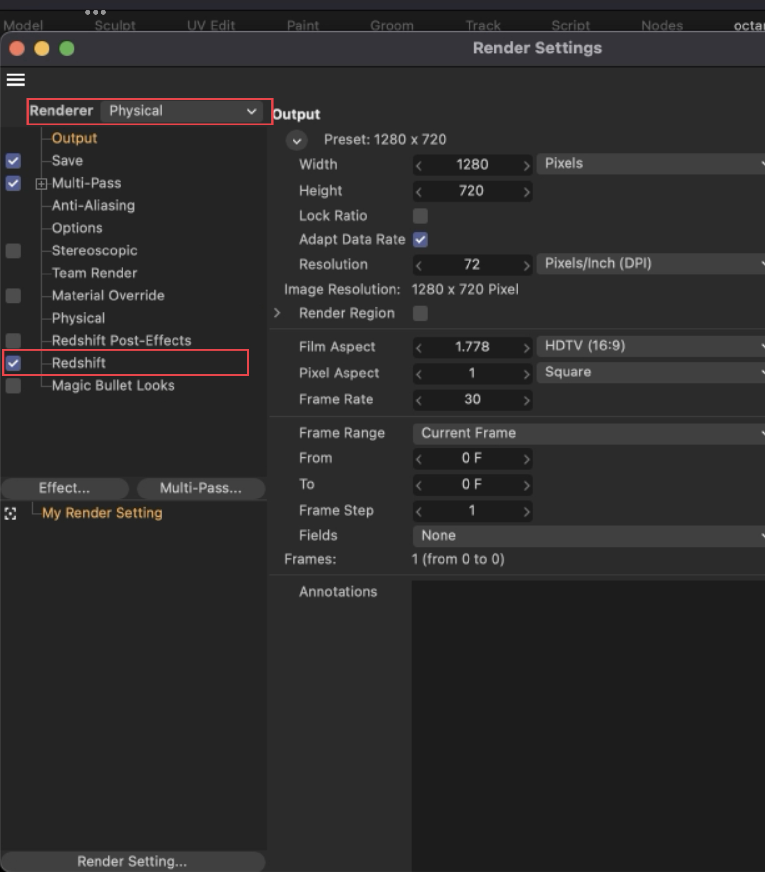

Please, always create a Render Setting specifically for OctaneRender, and avoid to mix it with other render engines, even standard c4d render engine:

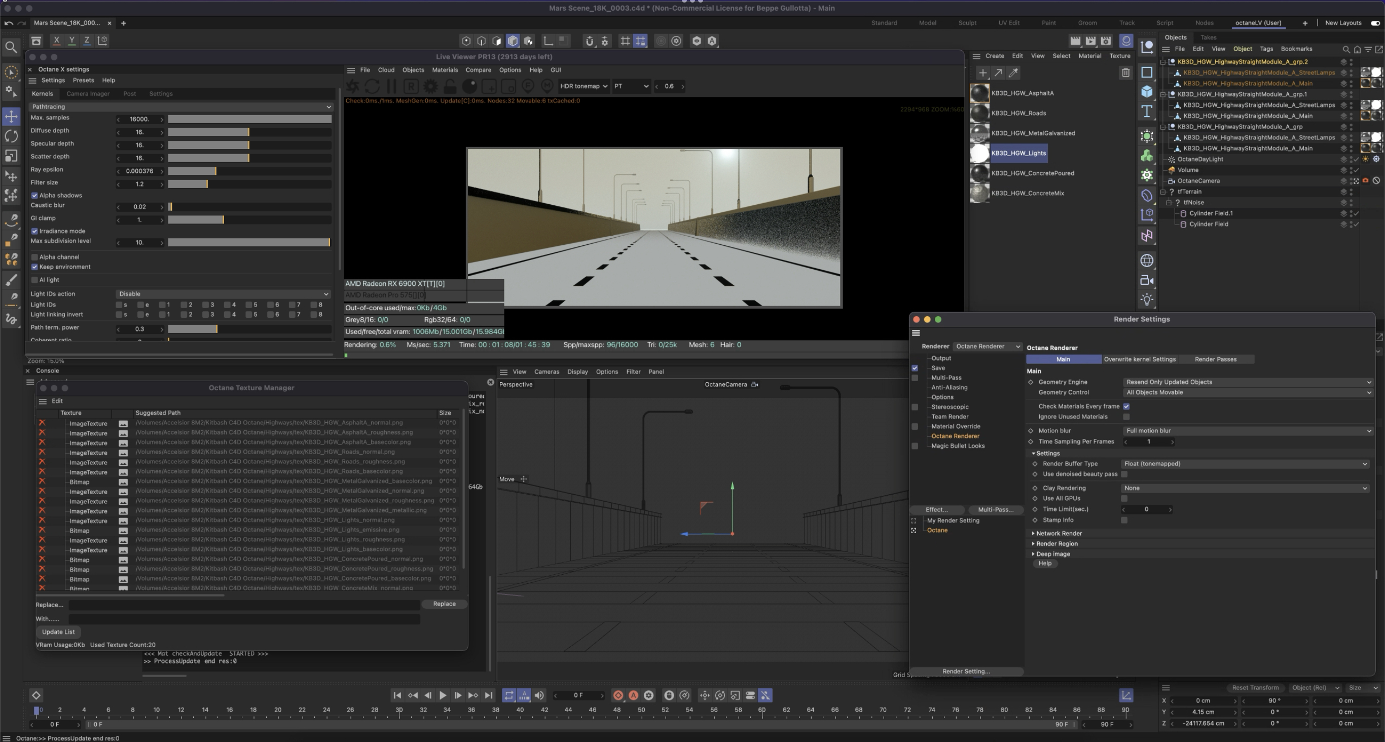

You have not shared the assets of the scene, but after switching to OctaneRender engine, everything seems to work as expected here:
