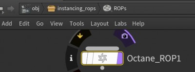

Then launching IPR from the Octane ROP:

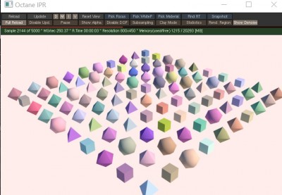

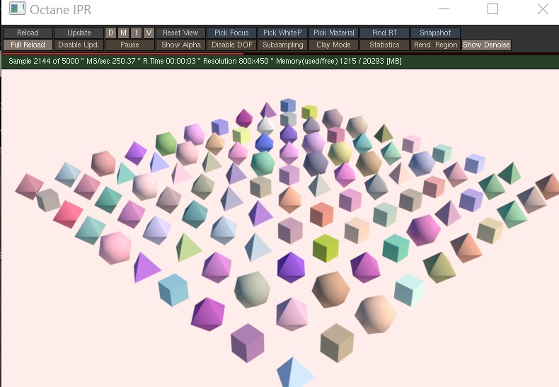

Produces this result:
As far as I understand it, this is considered the "correct" workflow for instancing in Houdini and reading in a color value for use in the shader (the only attribute that is supported for instancing), unless I'm mistaken there? Either way, this example is working.

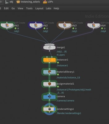

Here I have tried to replicate the same logic with this scene graph:
The instancer LOP is set to "Point Instance" method so there is only 1 copy of the source mesh in the scene graph and its instanced onto the points (if you set the method to Reference, it will copy the mesh and apply the attributes, but that isn't instancing).

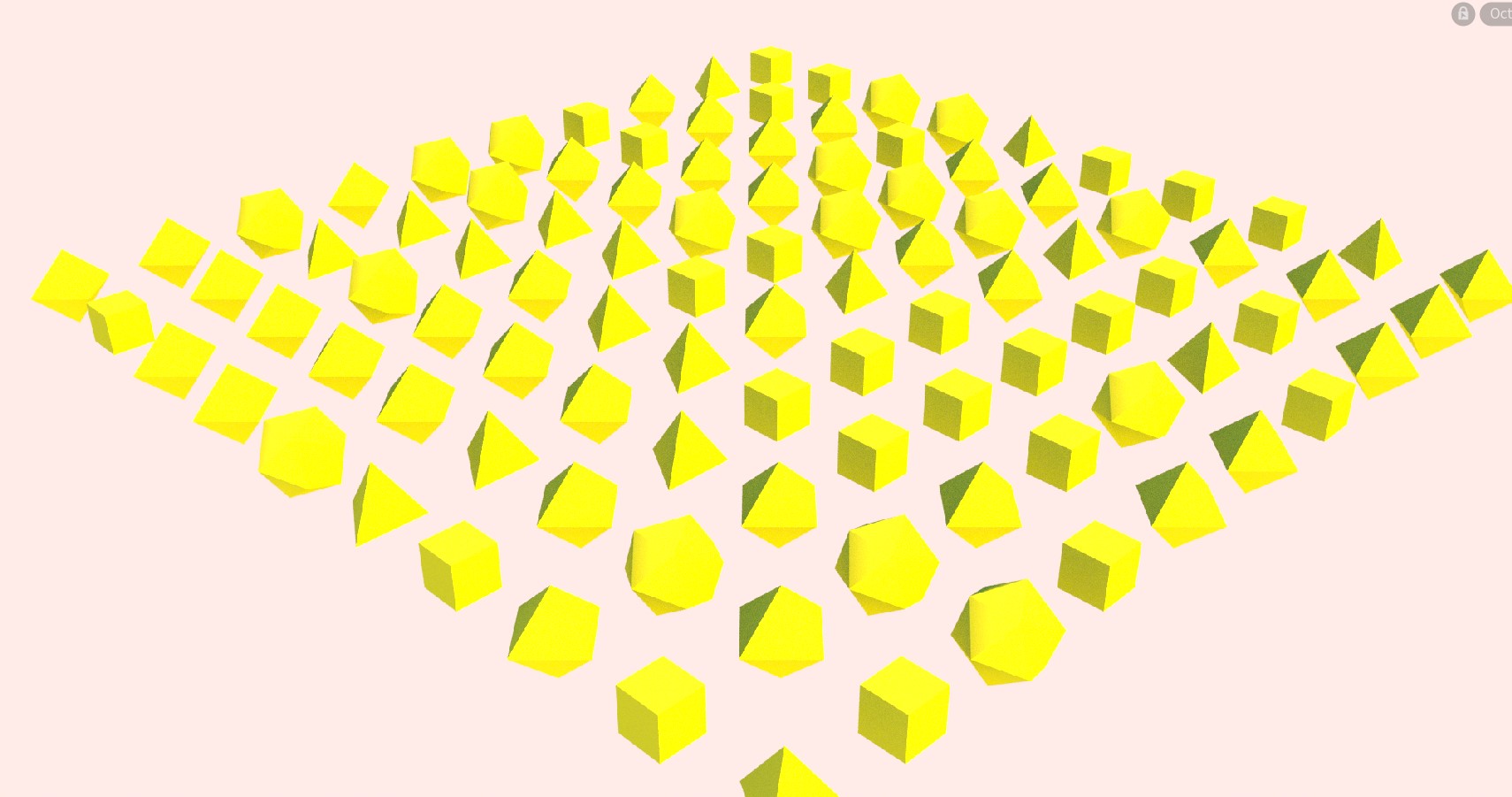

This seems to at least instance the geometry correctly when rendering with Octane, but the material assignment no longer works like it did before, it all just turns yellow

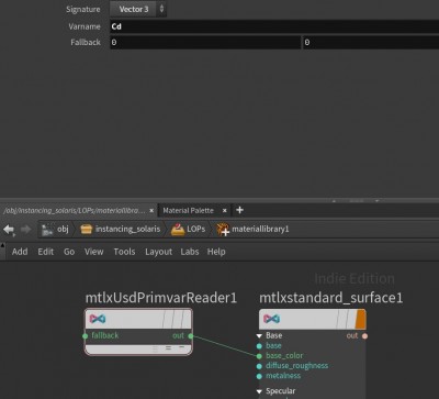

Ideally (and this is now a feature request rather than a bug) you'd be able to read in primvars for use in the shader, like you can with the materialX nodes
primvars on the instancer:
accessing them for the material:
