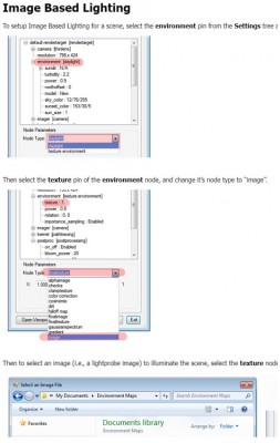

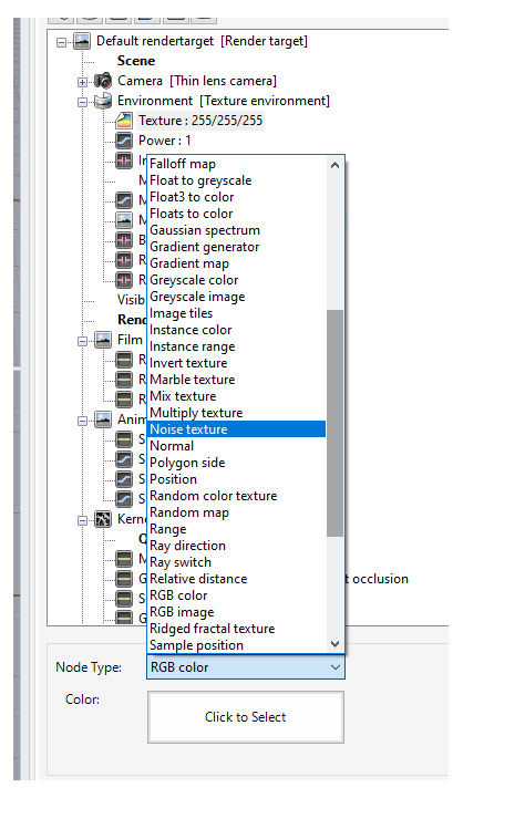

HI, ive been looking at the manual but it doesnt match the current version.
Do we load the HDRI map through the RGB image or image tiles ?
Here are the options currently

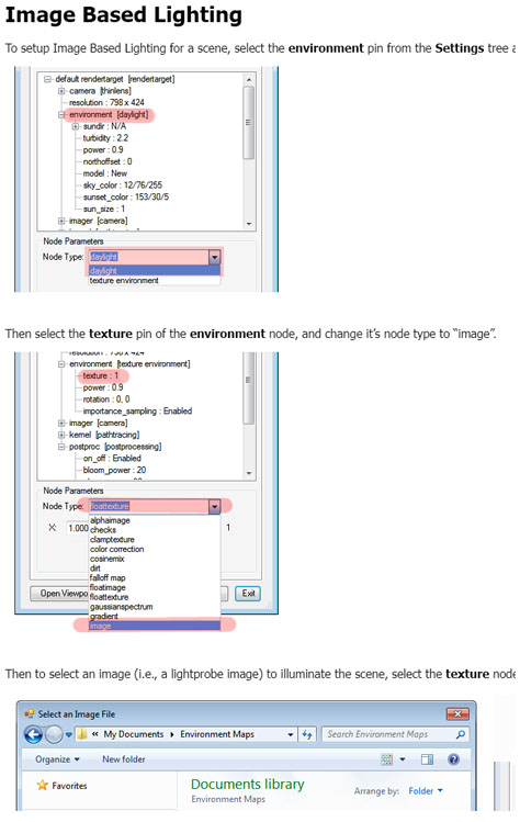

Here is the manual.

In standalone I always use RGB Image.

AWesome, that worked. Thanks for that ;)

Yes, you must use an RGB Image node type for a HDRI Environment.
