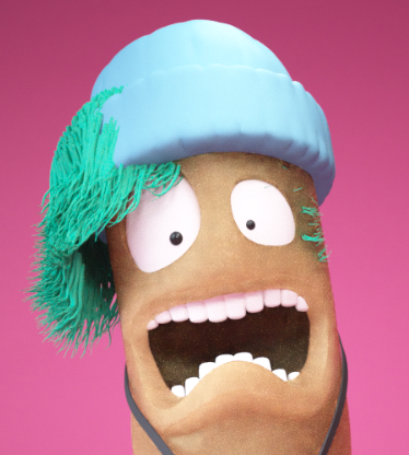

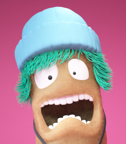

The main issue now is that when the object moves, the hair is moving to a different/exaggerated rate. So the hair is no longer stuck to the base that the roots are rooted to.
Again if I render through Picture Viewer it is all fine, but in the Render Queue I get this issue.... (see attached)
Queue:
Viewer:
Is this anything that can be fixed with priority ordering of the hair/base? The object is being manipulated by a bend deformer. Thank you.

If the hair is moving at an exaggerated rate, then you have a double transform happening. This can happen depending upon how you have assigned your hair object. The reason that the error shows up in Render Queue is because that is what Cinema is actually sending to Octane to render via its evaluation pipeline (Live Viewer does not go through the evaluation pipeline for performance purposes).
Rule of thumb: Always do a make preview to validate your animation. If it is wrong in the Preview, it will also be wrong in the render.
Priority adjustment may help, but hard to say for sure without seeing your file.
