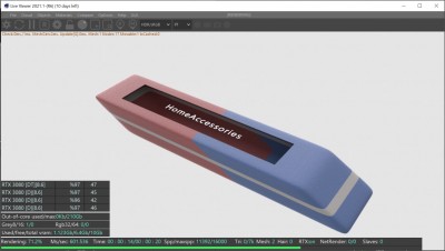

well, I just stumpled into another opacity problem, I don't get wrapped my head around. After a long time of troubleshooting, I have no idea what I am doing wrong.
I have modelled a polygon object, and made 3 different polygon-selection. Each selection gets a different material.
As the final step, I would like to put on a 4th selection a glossy material, with an imagetexture on top of it of a brand name for example
In my logical thinking, I should see the underlying material of the other selection through the black parts of the opacity map, and only the letters should be opaque. (Like adding an Add-Layermethod in Photoshop)
But, here is the result: There is just nothing around the letters and it makes the polygon-selection invisible, and I can see into the object.
Also: I discovered, when I try to put a brand labeling on a transparent material (like a transparent packaging box) on a polygon selection, the refraction of the material gets faulty on just that polygon. As soon as I delete the texture on the selection, it works physically correct again.
Please, can somebody tell me, how I achieve to put a label on a with selections textures object and only get the stanced out letter, and still see my materials under it?

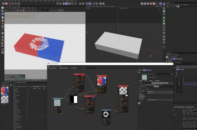

Here's the problem, our material stacking is not supporting the polygon selection. Divide your mesh to two parts and try. Or use texture mixing for coloring the stencil without breaking it.

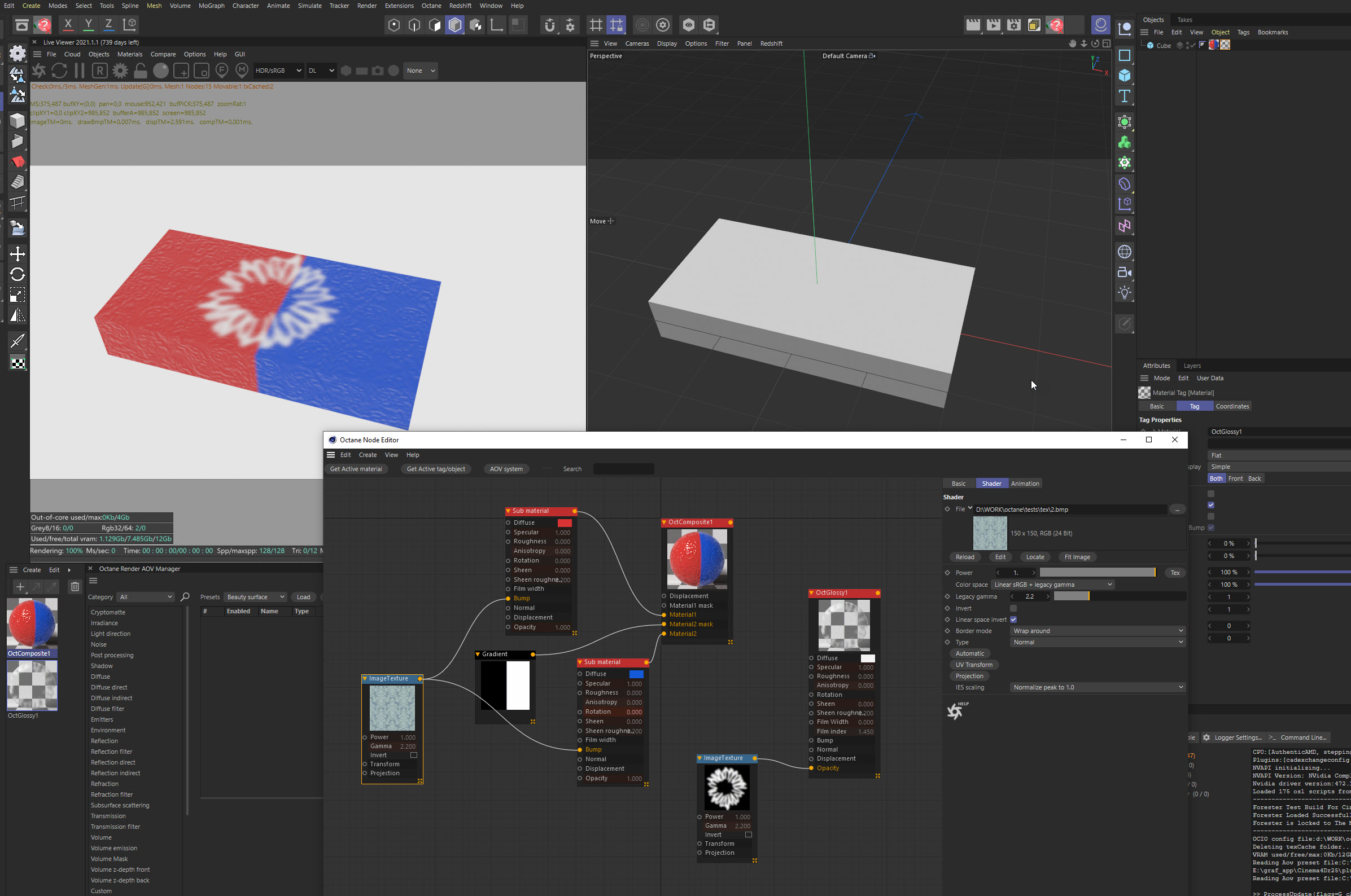

See this is possible as you see

Thank you, for giving me the hint how to do a possible workaround for that specific problem! It works with that workaround. And with a little fiddling, I can implement also a third color. So thank you sir so much!
