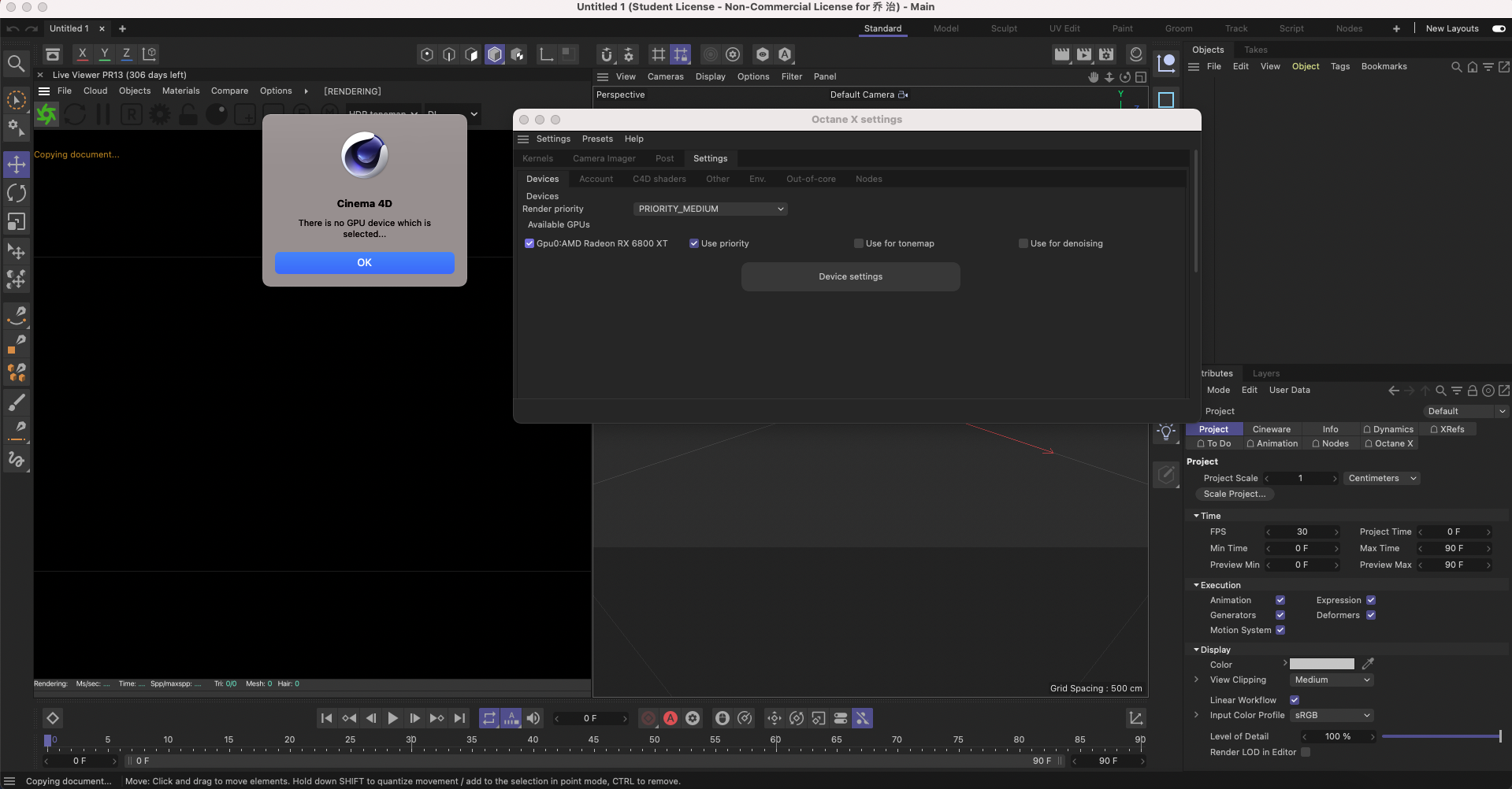

macos11.6.1 ,pr13。
weimi116
Posts: 2
Joined: Fri Oct 12, 2018 8:35 am
There is no GPU device which is selected...
Posts: 10597
You also need to enable the Tonemap option, or the render cannot start, but you cannot use PR13 under Big Sur, it works only under macOS 12.1 Monterey.
You need PR11 under macOS 11.6.1 Big Sur.
