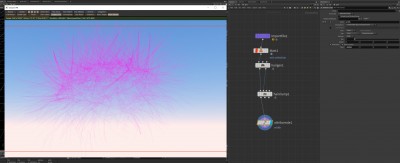

I have a problem with hair with a relatively small scale.
Because of the idea and optics, my head has to be around 3cm (which is not extremely small actually).
When I render the hair, the tips become fat, and the roots are regular. When I scale 10x it works fine.
I tried to flip the width ramp in hairgen, and it sort of fixed it, but the roots still a bit wrong. Other render engines are fine with that.
also the root and tip thickness in octane obj params does nothing.
2021-12-14 12_37_37-D__qSync_VURT_02_PROJECTS_01_Commercial_SLOTOMANIA_03_Workflow_Assets_Character_.png
hip file attached
thanks

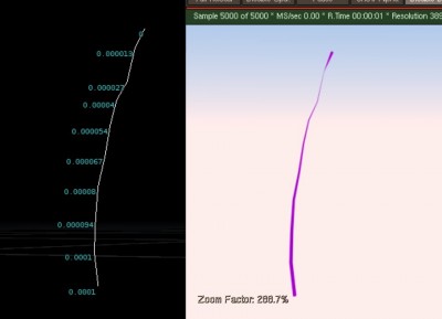

Just create a width attribute and set it to whatever you want or just go the the hairgen sop and edit the hair profile. Root and tip thickness in octane obj params does nothing because hairgen creates a width attribute that overrides whatever is in the obj parameters.

galleon27 wrote:Just create a width attribute and set it to whatever you want or just go the the hairgen sop and edit the hair profile. Root and tip thickness in octane obj params does nothing because hairgen creates a width attribute that overrides whatever is in the obj parameters.
Thanks,
the hairgen creates the width attribute tho. I was trying to remap it with attribute remap, and it did not help.
did you use the left or right setup?
since one of them has the width flipped, this was the only way to fix the issue, but not completely

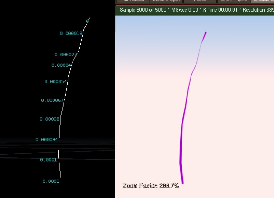

I was using the geo1 network. It does seem like there is a bug. It doesn't render correctly. Maybe Juanjo can look into it. For now just go to the hair profile and set the first point value to something really low like 0.000001 instead of 0. It should work like that for now.
I've attached a screenshot of the width attribute and how it renders.

Yeah, perhaps Octane has problems with 0.0 width points. Can you please check if avoiding 0.0 widths helps with your problem?

juanjgon wrote:Yeah, perhaps Octane has problems with 0.0 width points. Can you please check if avoiding 0.0 widths helps with your problem?
Thanks,
-Juanjo
Yes, it seems like it does! How didn't I think about this solution
