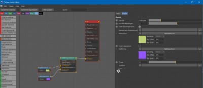

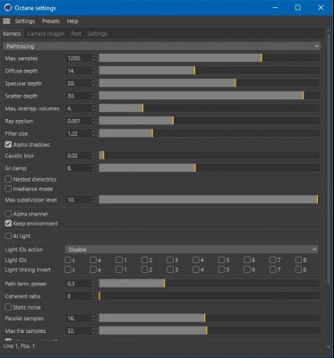

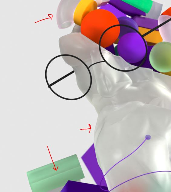

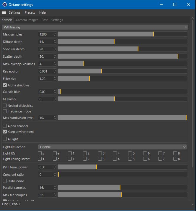

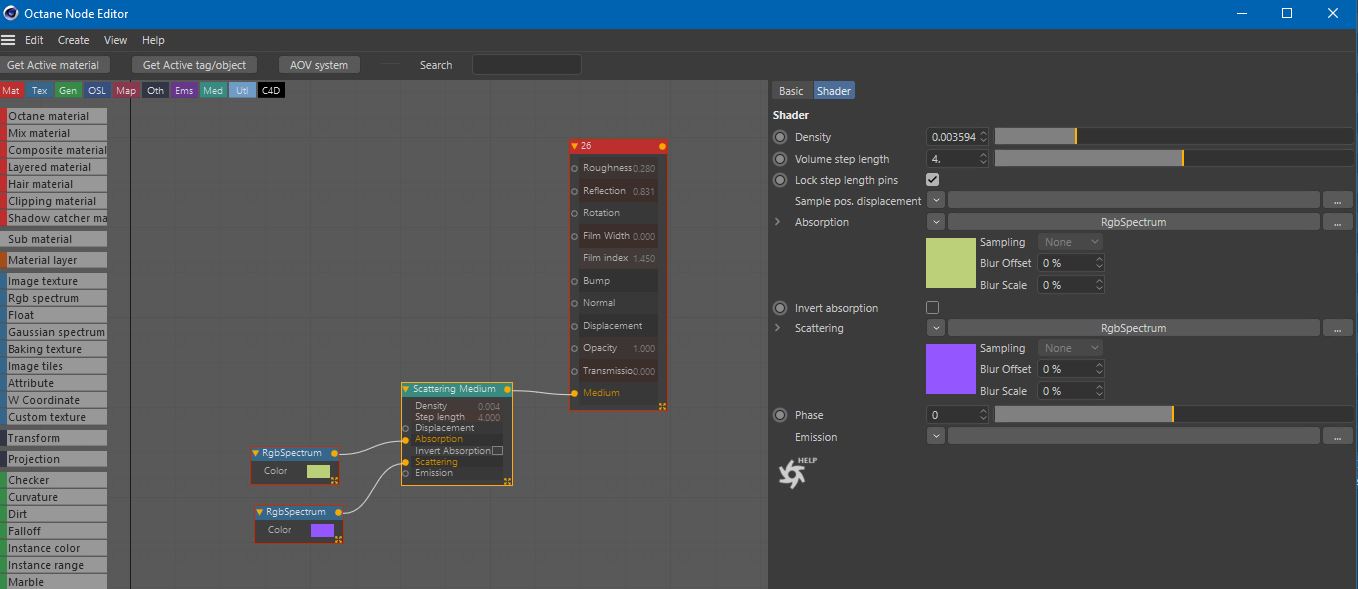

I'm trying to render subsurface materials (animation sequence) but no matter how high I set the settings, I still get flickers and movements on the SSS materials. It's like something is moving inside them. Here are the screenshots of the material and my octane setting.

difficult to see the flickering from screenshots, do you mind to share a video?

maybe I'm wrong, I cannot see the video very well due to compression, but probably the flickering is caused by AI Denoiser at a low Max Samples.
SSS effect needs more samples, so you need to increase the Max Samples in Kernel panel, to have a less noisy frame before performing AI Denoiser :roll:

I would:
- Increase Path term power
- Increase Parallel samples
- Lower diffuse + specular depth samples as much as possible
- Increase caustic blur (probably the specular material will be bit brighter)
- Turn on AI Light
- Turn on adaptive sampling
And see if that speeds up things a bit.

You should also enable "Static Noise". It will help reduce flickering when denoising animation

Thank you so much for the tip. Turning on "Static Noise" & "Ai Light" effectively removed a lot of noises and movements within the SSS. It is still a tiny bit but much harder to spot hopefully.
The other earlier suggestions did not work at all. Even setting samples at 2200 (Takes 5 minutes per frame with a RTX3090), did so little to reduce the noise in Sub Surface Scattering materials.
