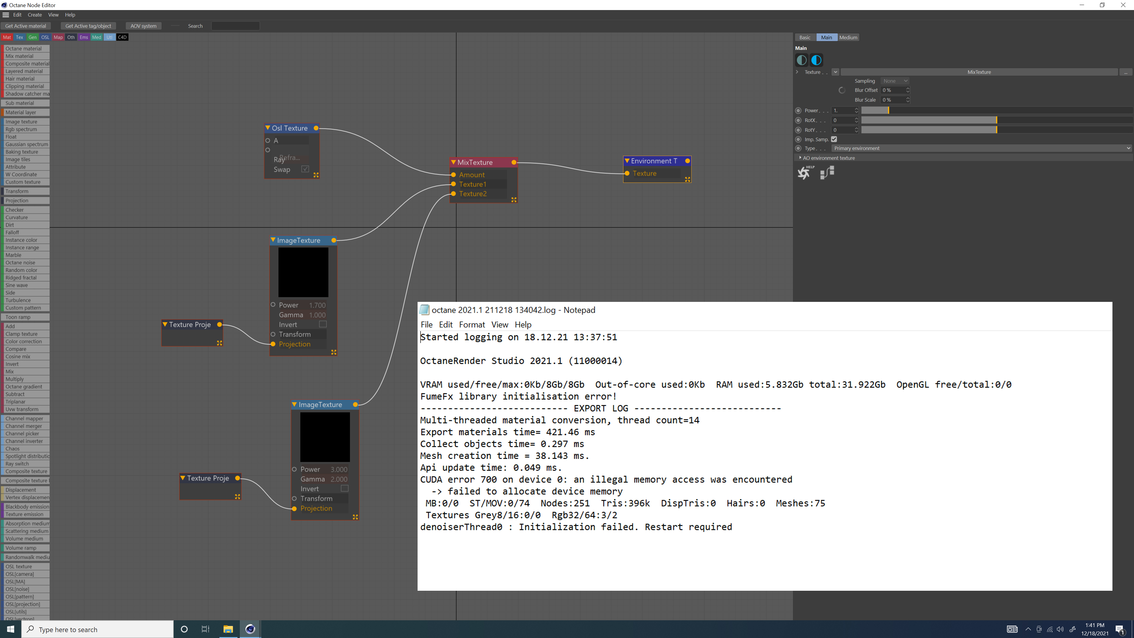

This script has stop woring in Octane latest version 2021.1-R4 with cinema 4D R23, can someone help me with this.
amitvb89
Posts: 7
Joined: Fri Feb 19, 2021 9:01 am
Kindly check the image
This error i am getting everytime.

Could you kindly please send the your scene with assets?

We released a 2021.1.1 standalone update (viewtopic.php?f=24&t=78954) which includes changes that prevent this crash. I checked the file from the linked thread in standalone and it's working.
Aoktar also released a 2021.1.1 update for C4D (viewtopic.php?f=85&t=78966). Please try your scene in the latest build.
