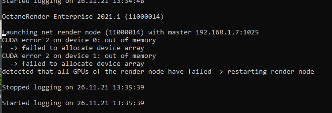

Two 3090s in the node throw out of memory errors.
If only one of them is active there is no out of memory error.
Node has 32GB of RAM and it doesn't waste all of it when two are active.
Hmm, 32GB of RAM for two 24GB GPUs is not enough for sure unless you have a huge fixed system paging file of at least 64GB. Be aware that the Nvidia drivers try to reserve all the GPUs memory also in the CPU memory for memory mapping even if it is not used. You can try to configure a fixed system paging file of at least 64GB to check if it helps.BorisGoreta wrote:Two 3090s in the node throw out of memory errors.

It doesn't matter how many 3090s are in the system, RAM usage is the same for 1 or 2 3090s, I've checked.
And they consumed only 18GB of RAM, started rendering and after 20 seconds, out of memory.
(this happens only in the node, in master computer 3090s render fine)

It's a regular out of memory -> failed to allocate device array error.
Funny thing is that it renders for 20 seconds and then throws out this error.
