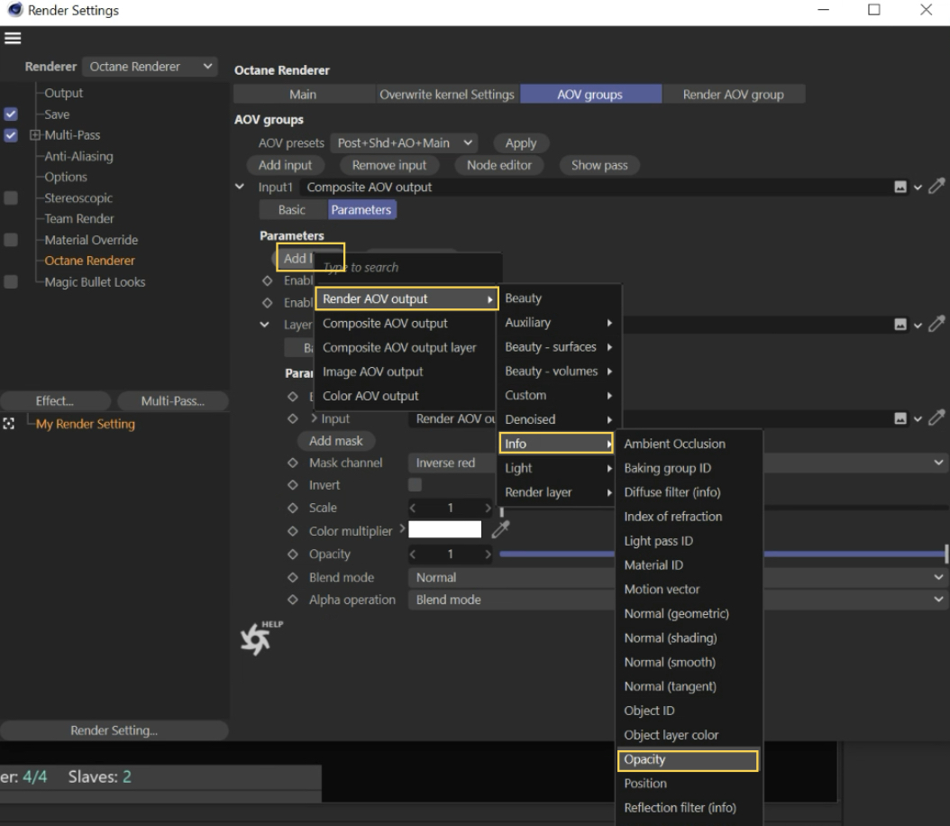

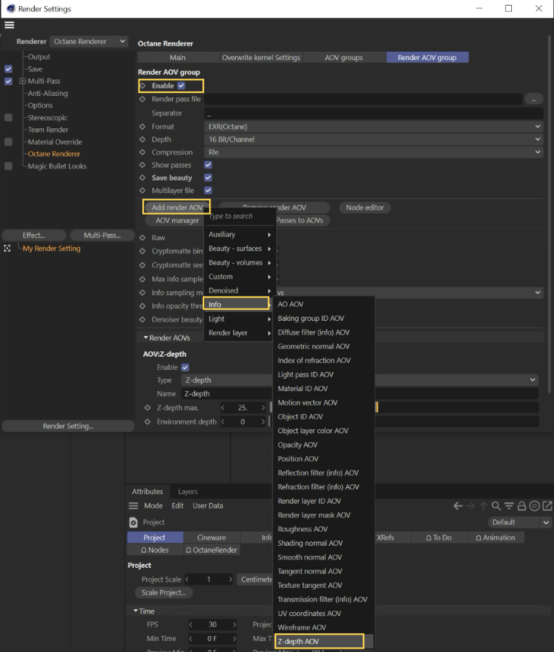

Ok, le's try with this example:
1. Go to Render Settings/OctaneRender/Render AOV Group, activate the Enable checkbox, and press Add render AOV, then info/Z-depth AOV:
2. Correct the Z-depth Max value, checking the result in Live View:
3. Go to Render Settings/OctaneRender/AOV Groups, and press Add input button:
4. We need the base layer for compositing, so, in the Input 1 node, press the All layer button, then Render AOV output/Beauty:
5. Then we need a White pass to mimic the fog on top of the beauty, so press again the All layer button, then choose Render AOV output/Info/Opacity:
6. Press the Node Editor button:
7. In the Node Editor, extract the Mask pin from the Opacity layer, and choose Render AOV output:
8. And choose as Input type the Z-depth AOV:
9. Finally select the Composite AOV node, and change the Alpha operation to Alpha compositing, you can continue to fine toon the Z-depth Max value, checking the result in Live View:
You can also use the Scale, Color Multiplier, Opacity, and Bland Mode to obtain different effects.
