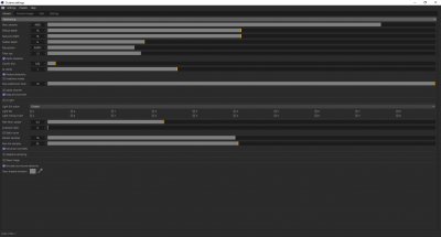

My render samples are set to 4000.

It will be great to examine every kernel parameters and see the effects of these to make more optimised scenes. In your settings maxsamples are high, there are unnecessary high values.
