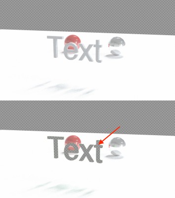

I'm trying to create an alpha render, so that it can be overlaid on footage. Is anything like this possible? I want the text materail to override anything behind it, I've mocked up a crude photoshop of what I mean:

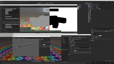

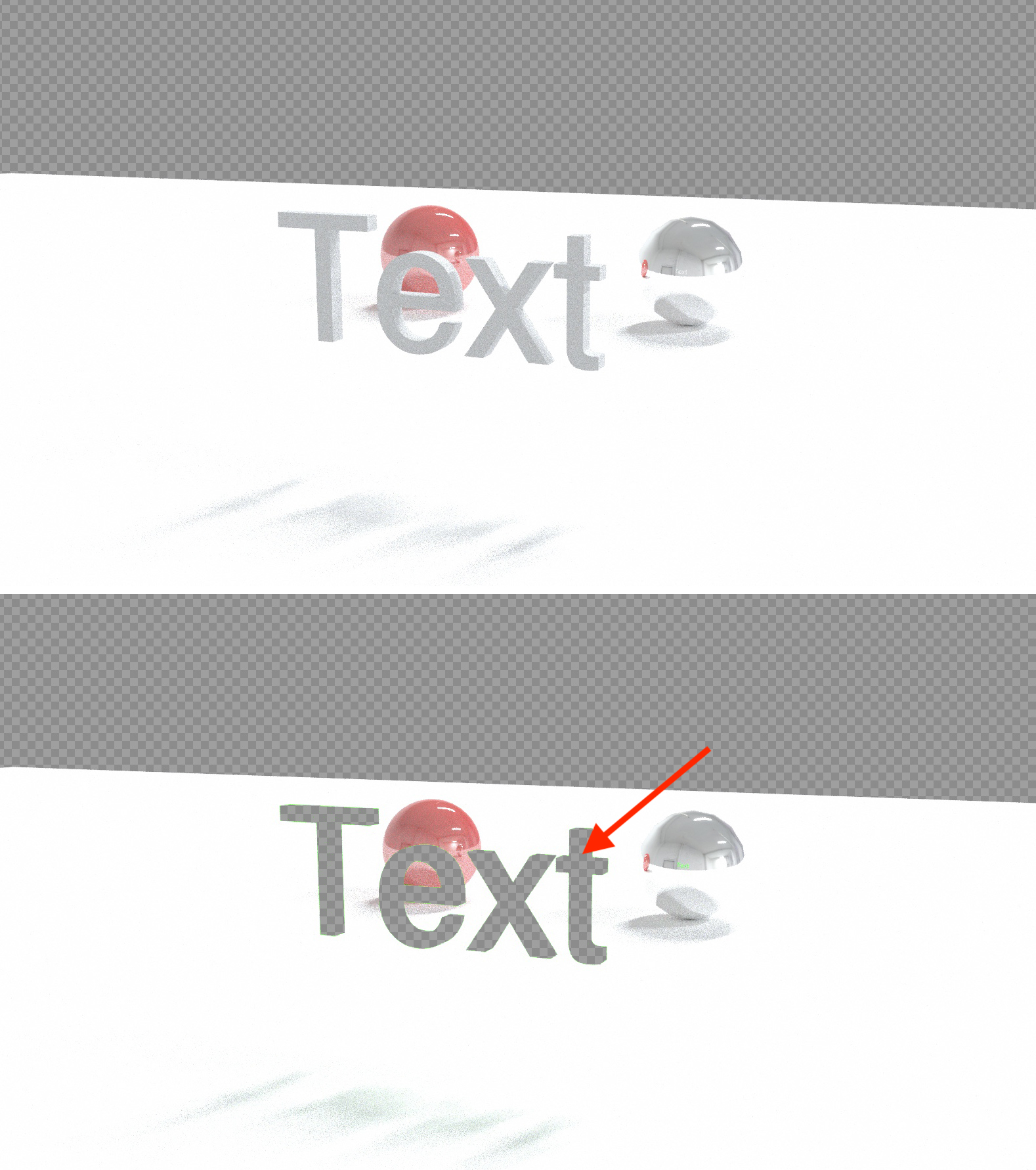

in 2021.1, you can use an AOV Group, and use the Object Layer Color pass to mask the Beauty AOV, in Alpha - Foreground mode.
In this case I have changed the Object Layer Color of the plane to White:
