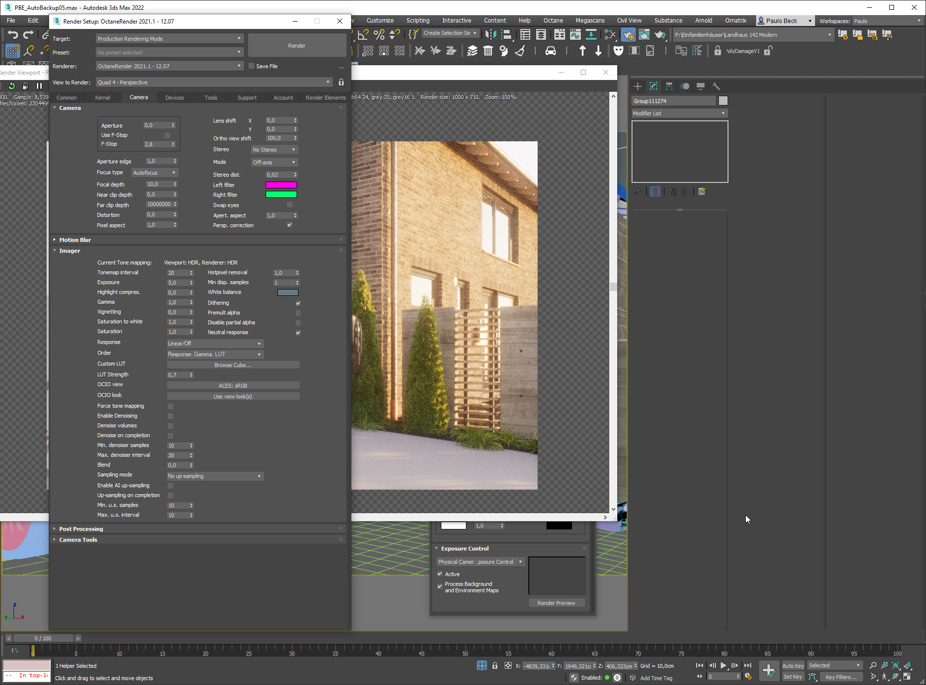

I don't know, I think I'm forgetting something ... My render is completely black, but if I switch to Viewport it renders as it should

can you share your scene with just a couple of objects and camera?

The issue was on DOF - aperture shape / custom i dont have any map apply to the slot
