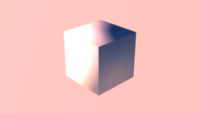

Just installed latest beta test for Octane Blender 2021.1 RC3 24.4.

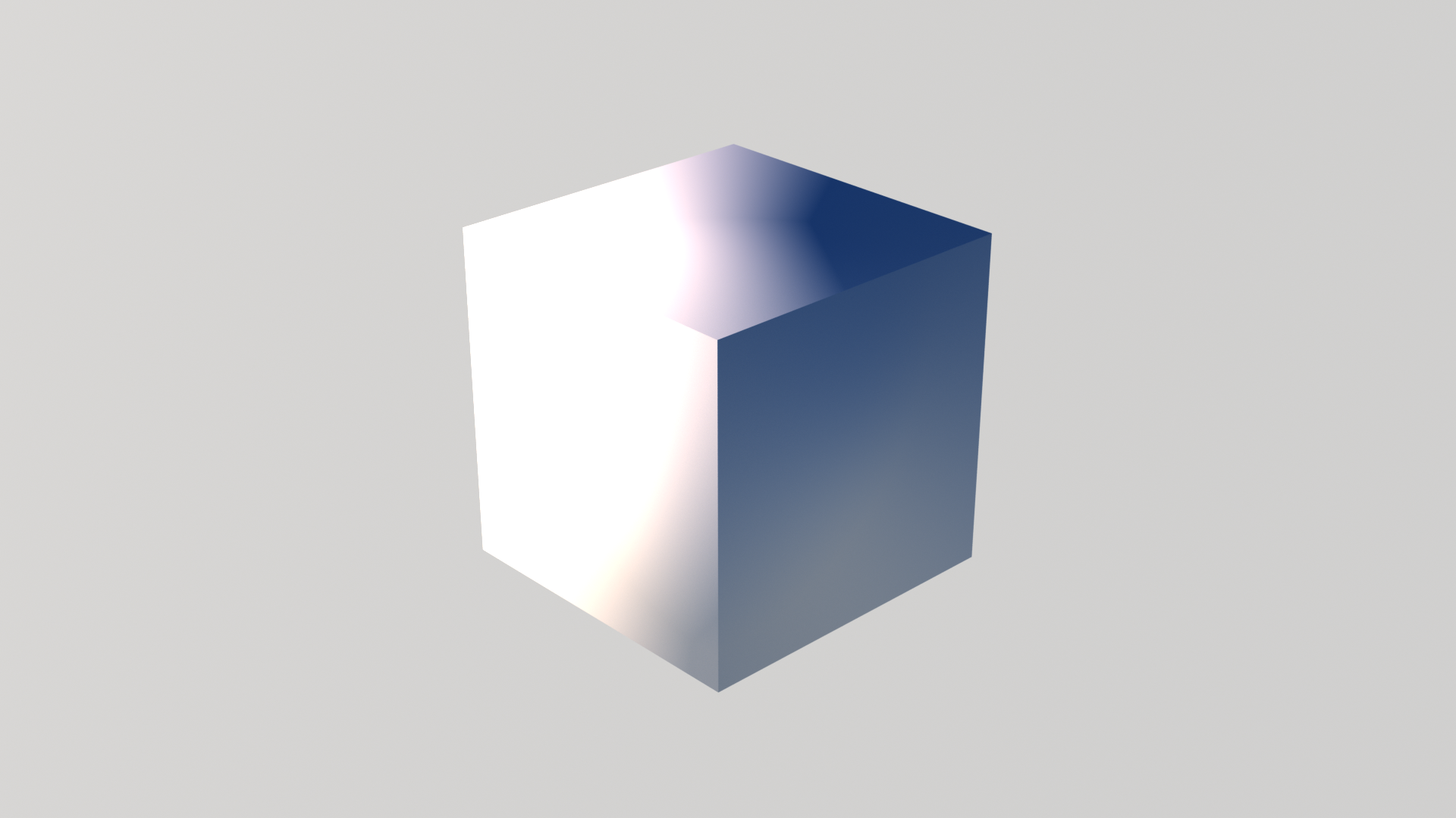

The default environment casts a strange overwhelming pink hue to the scene. See attached screen shots. Same file in Stable 2020.2.5 - 23.11 renders normally.
20201 RC3 Pink Cast to Environment

That's something really odd. Can I see you're environment options?

Yes I did, I just would like to take a look at the user options, so to identify exactly what's wrong.
The general guidelines to set Color Management/Octane Imager option right:
1. Go to Scene tab in Properties window (Blender 2.79)
or go to Render Properties tab in Properties window (Blender 2.8x).
Expand Color Management and set:
* Display Device: sRGB
* View Transform: RAW
* Look: None
* Exposure: 0.0
* Gamma: 1.0
2. Go to camera tab in Properties window and enable Octane Camera Imager (Render mode)
3. Alternatively go to 3d view Properties panel (N key shortcut), locate Octane Camera Imager (preview Mode) and enable Override. This way all cameras will have the setting from this panel.
