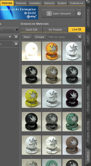

This is a long-standing issue with the DAZ Studio Octane plugin, but I wanted to confirm it's still open:
The LiveDB material names are often blank/just a dash and refreshing the db in-program does not fix the issue. It seems random, because sometimes the material names show after restarting Daz Studio.
Thanks!

wader wrote:This is a long-standing issue with the DAZ Studio Octane plugin, but I wanted to confirm it's still open:
Thanks!
- Windows 10 Pro
- 32GB RAM
- GTX-970, 2 x Titan X(Pascal)
- (always the latest Nvidia driver)
- DAZ Studio v4.16
- OctaneRender for DAZ Studio Enterprise 2020.2.17.61
Hi wader,
Thank you so much for the post.
We are able to replicate this issue.
cheers
