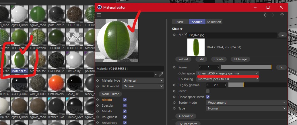

Hi, Aoktar
After bringing some 2020.2 projects into 2021.1 RC3(r2), I noticed some shaders have a different gamma/exposure compared to the older engine. Am I missing something?
Regards,
PS: Have just realized, Color space in those cases are set to <<non-color data>>. After switching back to sRGB it got like before. Any way to set sRGB as default?? In the cases the shader has no issues I noticed a <<Linear sRGB + legacy gamma>>, so why doesn't it upgrades equally to all image cases?
Automatically upgraded color space
