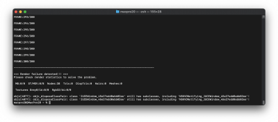

thr devs are investigating the issue, in the meantime, please try to export the .orbx scene via Terminal/command line, here is the syntax for R23:
Code: Select all
“/Applications/Maxon\ Cinema\ 4D\ R23/Cinema\ 4D.app/Contents/MacOS/Cinema\ 4D”  “path to .c4d scene”  -nogui -exportORBX “path to .orbx saving”
Basically you need to right click on c4d app, choose Show package content, navigate into Contenta/MacOs and drag and drop the Cinema 4D exe file in the Terminal window:
Drag and drop from the finder the desired .c4d file, then write `-nogui -exportORBX` and then the path where to save the desired .orbx file.
In my tests it has always worked 100% with both Catalina and Big Sur, please let me know if it works also for you.
If you have AI Denoiser active in the scene, you will see an error at the end of the export, but the exported .orbx scene will render correctly in RNDR:
ciao Beppe
