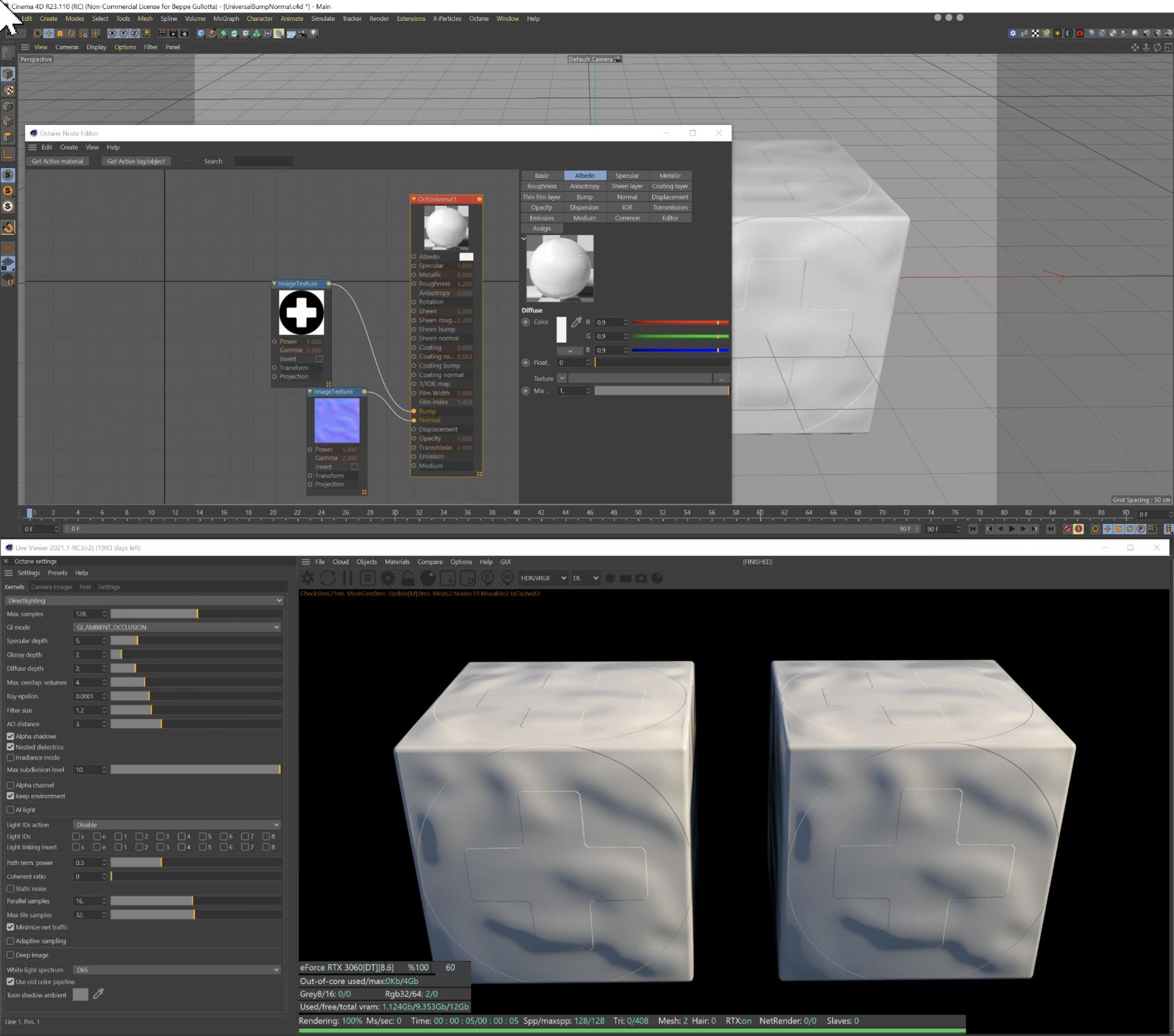

anklove wrote:Bug report:
Normal map doesnt work in the Universal material if you also have bump texture. In the glossy mat it works as intended.
This bug is also in 2020 release.
Everything seems to work as expected here with Bump + Normal in Universal material (right), and Glossy (left):
Could you share a scene with assets that shows the issue?
ciao
Beppe
ciao
Beppe
Okay i found an issue. The bug appeared if you have a sheen layer. You HAVE to put BOTH your normal and bump into sheen's normal and bump channels.

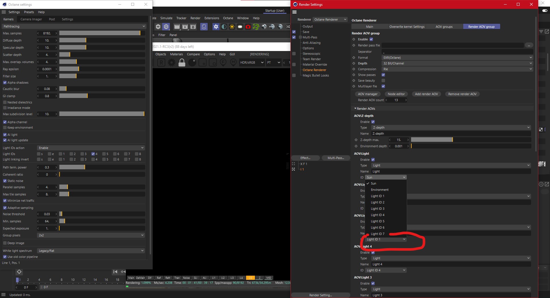

Hi, Aoktar
The plugin feels great so far!
Is the "Light pass 8" missing in the "Render AOV group" tabs?

Posts: 10325
anklove wrote: Okay i found an issue. The bug appeared if you have a sheen layer. You HAVE to put BOTH your normal and bump into sheen's normal and bump channels.
Ok, so not a bug but how the Sheen layer works for Universal material.
If you don't specify a Bump/Normal map, the sheen layer uses the default shading normal. Otherwise, it applies the bump/normal-mapped surface to the sheen layer.
