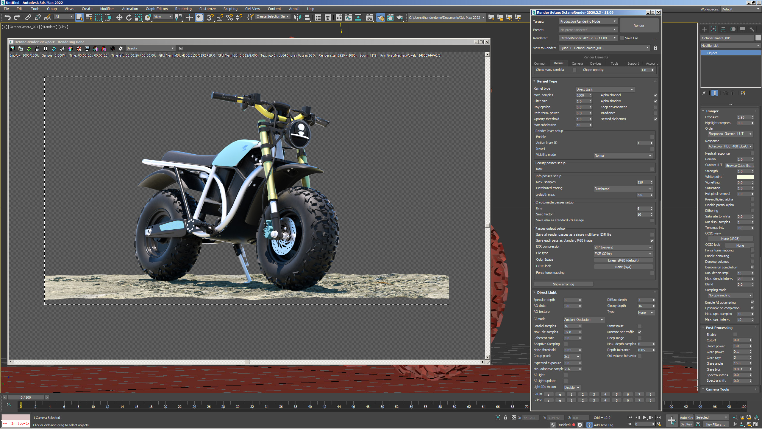

Hi All,
Im having some problems with strange shadow banding and general weird results in dark areas on several different projects. In the frame buffer, the shadows look perfectly fine, and when I save them out, they show the strange banding problem. Does anyone have a guess as to why??

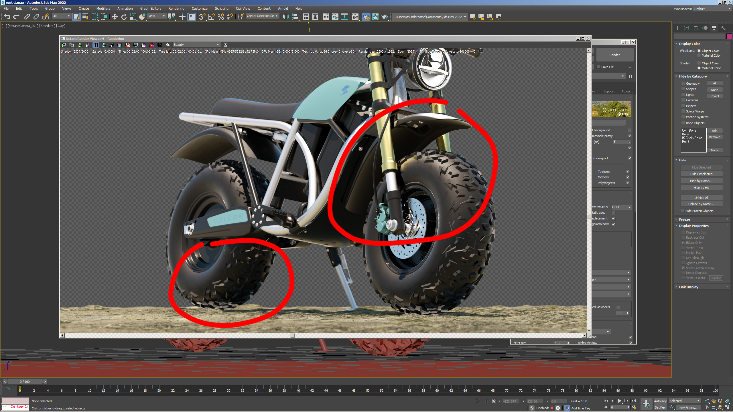

Yes, youre right about exporting a PNG, but they were 16 bit PNG's. I wonder if that made any difference? Its interesting to note that for other older versions of Octane I never had this issue.
I will give the EXR 16 a try. Thats what I would have exported had this been an animation for After Effects. My only reservation about EXR's is that they dont play nice with Photoshop.
brianzero
Posts: 22
Joined: Mon May 09, 2016 2:15 am
I tried EXR and get the same banding as the PNG's. Could this be a bug specific to this version of the Max plugin?

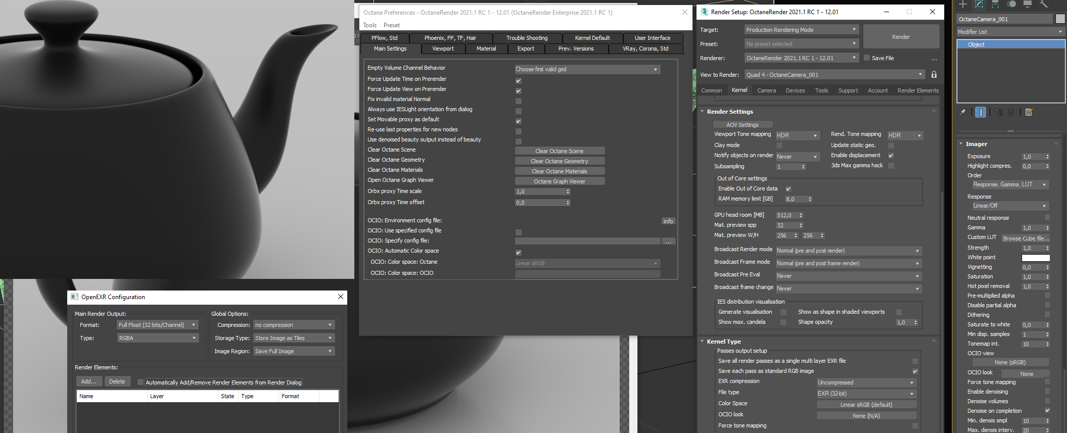

paride4331
Posts: 3923
Hi brianzero,
try following my setting.
Regards
Paride
brianzero
Posts: 22
These setting seem to fix the problem, thanks Paride. My question is to the developers, why set the LDR as 'Default Active Viewport' when it creates problems like this? If I save any file when the LDR mode is enabled, the results have errors. Why not have HDR 'viewport mapping tone' set as a default?
