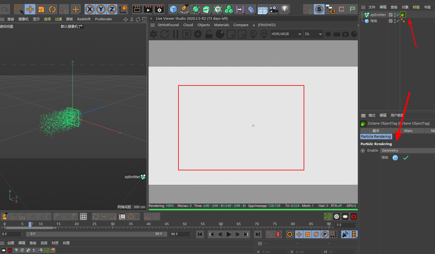

Why can't I render particles with OC objecttag on XP emitter
X-Particles works correctly in c4doctane 2020.2.5-R2, but you need XP 895 version or greater: This is caused by a change in the X-Particles API, not by c4doctane itself.

Thank you very much. I thought it was caused by accidentally turning off a certain function.
