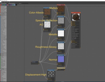

So ive got a a fair few tutorials on Nodes building in Octane C4D but in all tutorials the teacher seems to be going off on a mad Node rampage. As a complete beginner im looking for an Octane Node tutorial that starts off with the basics of what to do with the 4-6 textures that normally come in the folder of a free PBR material?
Please can someone tell me how to build a basic material from the usual jpegs that come in a PBR folder like: Is there a tutorial?
-Colour
-Disp
-Gloss
-Norm
-Reflec
-Metallic
-AO
Normally I find 6 different JPEGS in a PBR material folder max but here ive probably duplicated one as they often use different names. But if someone could find me a tutorial on how to get started with the basic textures and build the Octane Node id very much appreciate it :)
Posts: 10356
here is a classic PBR setup with octane Universal material.
All the maps are connected directly to the Universal material, a part from the Displacement map that needs to be firstly connected to a Displacement node, and Color-Albedo + AO, that need to be connected to a Multiply node:
ciao Beppe

Thanks Beppe, that’s exactly what I needed. Now I know the basics I can work from there onwards.
