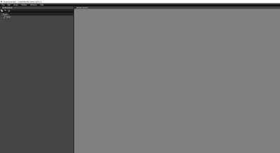

i just installed poser 12..and i wanted to try the octane plug in before i buy it..
i installed octane demo version
as you can see..and then i downloaded and installed "OctaneRender_for_Poser_2020_2_3_108_DEMO"
file...

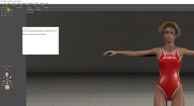

when poser starts it gives me this message and i dont know why....
could you please help me?
thanks...
thanks...
im running in windows 10 2 cards RTX 20280 latest drivers...
The plugin installer prompts for the Poser location, which could point to an older version of Poser. Poser 12 by default installs to Poser Software/Poser 12 in Program Files.
It will install itself as an addon in the Runtime:Python:Addon folder in a folder called OctaneRender.
From the message it looks like the OctaneRender folder is found, but not the code inside it.
This could be an issue with permission since it is located in a protected area of Windows which I think needs admin permission to write to.
I am not sure this is the problem, but it is worth checking out that plugin folder.

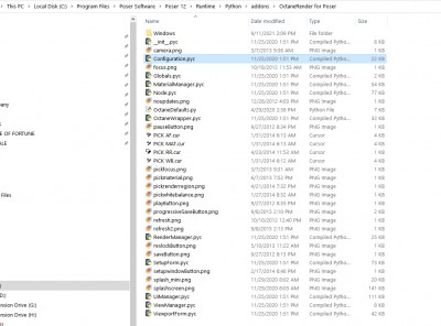

can you show the contents of the OctaneRender folder in the addons folder. Maybe I can see what is missing by comparing it to moine.
yes here it is...
thank you so much for your help so far ...i really appreciate it!

isikol wrote:i judt bought studio licence and nothing..still the same...dosnt play..same message...i thought it was a demo version issue...but its not
I think I see what the problem is - but not how it happened.
The problem is that the folder name is wrong - Not sure when it change, but I think it was from P11 to p12 support.
Your Octane plugin folder name is "OctaneRender for Poser". My foldername is "Octane Render". This would also explain your error when you start it - it does not find the code since it is located elsewhere.
If this indeed is the problem, solution is easy: Rename "OctaneRender for Poser" to "OctaneRender" (remove the " for Poser").
On my install it does not happen, but I use the enterprise version, not the studio version. Paul (FaceOff) should know and can fix it.
Hope this works.
